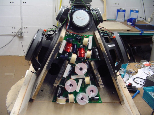

Hi JLH,
Thanks a lot for very elaborated reply regarding the sound quality of the SH-50 and its sister models, I really appreciate it!
The SH-50 sure seem to excell in many areas. You are a very experienced DIY'er and I would like to ask: Besides the 'hotness' in the highs, was there any other areas where you would prefer your own setup relative to the SH-50's - well maybe besides price?
One final question: Do you have any idea about the crossover components used in the SH-50s?

From the attached picture, it looks like Tom uses poly caps and air core inductors where he can. For larger values he uses Bi-polar electrolytic caps and iron core inductors. I would agree that the parts are not "Exotic", but are of decent quality. When/if I complete my project I will be using better quality parts. Probably Mills resistors, Auricaps, and ERSE coils. I'm also throwing around the idea of battery biasing any caps that appear in series with the compression driver, or mids.

So, in the end, if you'd be doing a home-setup, kind of your first project, what would you choose? A two way, oblate-spheroid waveguide + 15" woofer, or an Unity?
Why? Good design trumps all and obsessing about the differences between two otherwise well made PP caps is for those who can't do that.

Definitely a Summa. The resale value on a DIY unity is basically nothing. Believe me, the Gedlee speakers are going to be collectible. You could buy a Summa and be listening to music this week... Or spend half a decade obsessing over the Unity.
Besides the time investment, I've also had to buy a bunch of tools. For instance, I had to buy a drill press to get the holes perfectly straight and centered, and a bunch of router bits to chamfer the ports.
As you know DIY'ers can at times have really long discussions about differences between single components. It was just my 2 cent comment that achieving excellent results with good, but not exotic, parts put such discussions in perspective...
