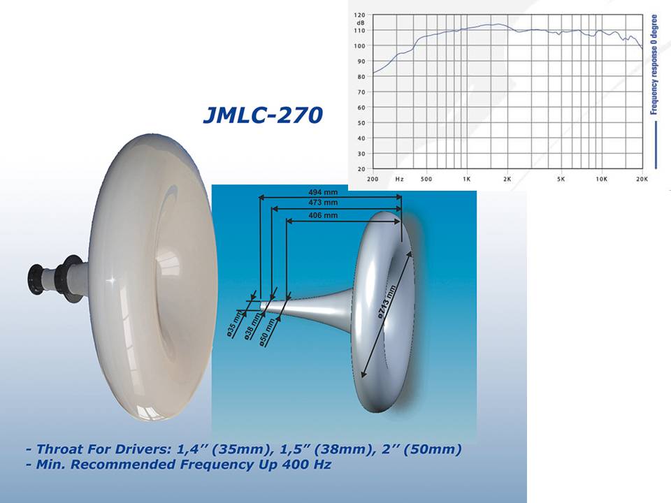

Do you think a larger horn like the JMLC-270 that can cover 500-18Khz with a carefully selected 1.4" compression driver would get closer to the "x-ray detail" of the Synergy by maintaining controlled directivity down to say 500Hz?
Additional listening impressions of a JMLC-270 would be welcome.
Thanks, Patrick for your detailed impressions of the most interesting horn/waveguide systems. They mirror my own experience (except I haven't heard a Synergy yet). The spatial impression of an OS and a LeCleac'h horn are strikingly different, yet both have very good impulse response. It's hard to describe unless you've heard it for yourself, and people who have only heard the not-so-good horns at hifi shows won't know what you're talking about.
