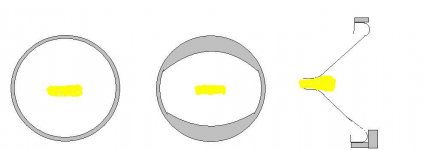

My thoughts are that the attenuation is much greater on the primary wave relative to the HOMs in the throat than the portions out from the throat.
Although I have spent many hours on them, I doubt my throats are 'correct', or my workmanship perfect. They are good, but I think I feel better with a little in the throats, if that counts for something. Still, I guess if I used the same ppi count in the throats, given their surface area and the fact that all sound must pass through there, they will have a relatively smaller effect than the foam further out.
My thinking is that the throat is the most tube like of the structure, and thus would be most prone to standing waves/HOMs/ETC, so this is where I'm focused on.
I have, however, been playing with enhanced termination of the horn mouth. Attached is a diagram showing the current state of foam (the most foamy version) and also the halfway version with just a foam collar.
In these instances it's open cell rather than reticulated. The attenuation isn't problematic since loss is outside the desired coverage window, in fact it's very much desired to extend the directivity (but not the loading) of the horn lower in frequency and absorb energy as it transitions from the coverage pattern to free-air.
Jury's still out, I haven't validated with measurement or even a serious listening test, just went ahead and fabricated the collar and a couple crescents to try the sideways cat's eye. Listening the past few days has been very impressive. I do seem to be getting much of the benefit of a more directional vertical without the horn unloading within or near the passband (common issue with normal asymmetrical horns)
