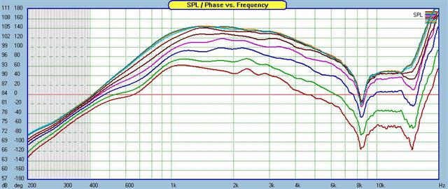

I've been looking at the curves and thinking about the "constant directivity" issue. Since the SPL is almost constant within +/-22.5 deg, if we toe in the speakers at 45 deg, and sit at 60 deg position so that the speaker axes cross in fron of the listener, we are sitting 15 deg off axis, which is still in the constant directivity region. As we move to the side, it seems best that the time difference shift best be the same as the intensity difference shift. Has anyone calculated this for CD speakers?
When I measure the wave guide again, I plan to rotate about the AC axis but indicate SPL angle from the mouth plane.
Soonsc
If you read my white paper on the Summa you will see that this is precisely why I toe in the speakers and that this effect has been carefully worked into my designs. But don't forget that the off-axis response at the crossover must also be constant directivity, which is not so easy, and again, it is precisely why I use large diameter drivers - for their directivity NOT their LF response.

Your paper talks about toe-in for delayed reflection but not intensity/time difference shifts.
