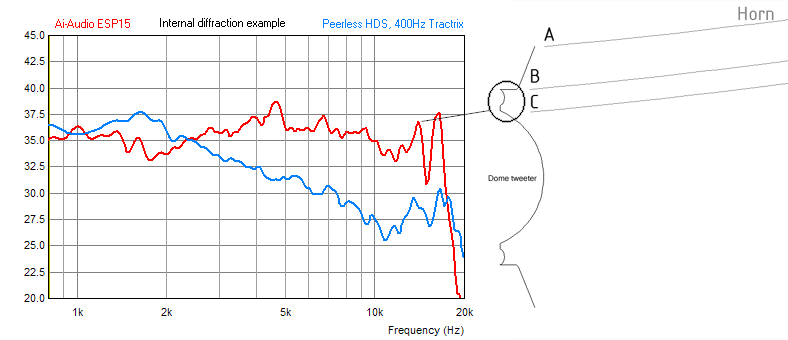

depending on the strength of these peaks in the CSD, they may not be cavity related. actually they look too pointed to be cavity related.jzagaja said:I've refreshed my horn project and realized that Summa and mine have similar diffraction problem from small cavity around membrane. See attachment "Twin peaks".
soongsc said:
I could demonstrate how significant it is if it's cone breakup.
In a blind test? I think not.
I've changed ring that surrounds dome from rubber to foam and Q has changed dramatically - see previous measurements in this thread.
Jack
Jack
