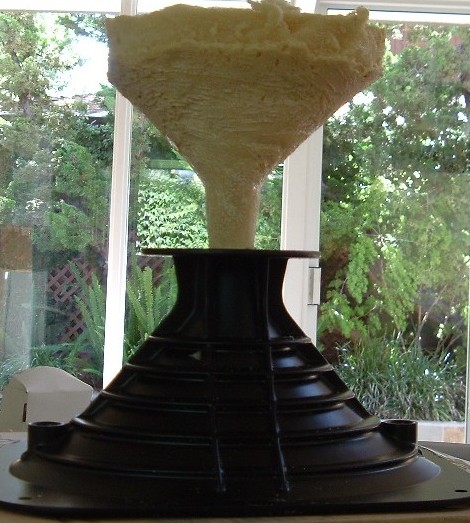

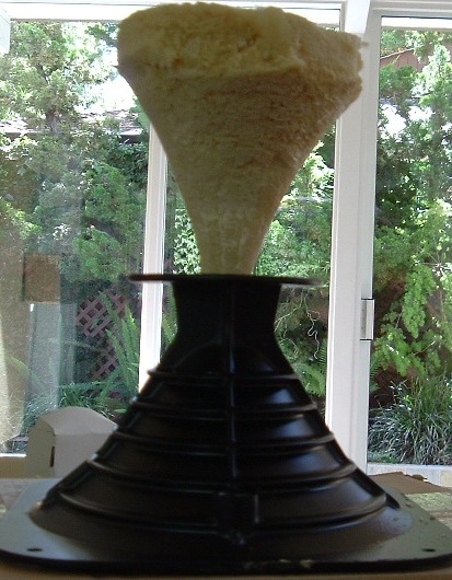

XT1086 shape
I made a mold of the interior of the XT1086 with expanding urethane foam so that I could slice it up into 1/4” (6.35 mm) thick pieces for patterns to make foam plugs.

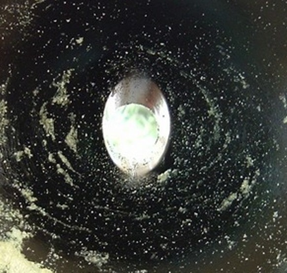

It turns out Vaseline is not an adequate mold release, so I’ll have to do it again, but now we can see the shape better.
In the vertical (narrower) axis the shape looks very nice, but in the horizontal it has a definite kink.
Also the Vaseline makes the edge more apparent in the picture looking into the horn.
Earl, or anyone else who feels qualified to comment, what’s the worst that could happen if that edge is smoothed over? BTW the wall thickness is about 4 mm and stiffening ribs run right over that area, so I think it’s safe to do.
Will it have an effect on the coverage angle? I’d actually like narrower horizontal coverage because the L and R speakers have very different sidewall distances.
I’d actually considered rotating the horns 90 deg to have 60° x 80° instead of 80° x 60° H x V coverage, but I’m limited in the vertical dimension of my boxes.
Vertical axis:
"what’s the worst that could happen if that edge is smoothed over?"
Nothing bad. You'd have "less" diffraction because the corner wouldn't be as sharp. Don't know if the difference would be audible.
