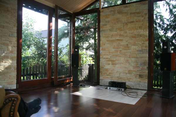

Dr. Geddes do you think waveguides will work in glass room like this? The sound is very fatiguing even if you use non fatiguing drivers.
