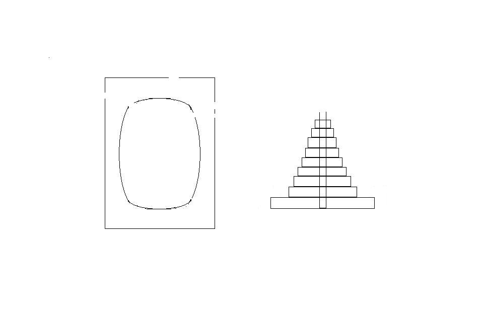

Thats why a diy approach would be ok, a bit of sawing, filling and sanding and its done :clown:
"But these could be as high as $4000."
Oh, that's not so bad, I thought it was in the tens of $K.
So obviously the problem is not enough qty to amortize the mold cost.
Hopefully the kits will increase awareness and achieve critical mass in demand.
tinitus, that's not an ellipse.
But it's an interesting idea to take it to the limit and just leave out the mold.
But it seems like an awful lot of handwork would be required.
gedlee said:
Those kind of molds last for about a half dozen parts, then they split or somthing
You just need to use polyesther filling and finish the mold with glassfiber and topcoat, then its more durable, the tricky part is to end with the right measurements, which I reckon will have to be very precise, at least at the throat ... but yeah, its a lot of work
I've made and used every kind of form that you can imagine and as anyone in the biz will tell you anything but solid metal will fail eventually, its just a matter of when.
Offcourse, a solid glassfiber mould will eventually wear down after several years of daily use, and it will have to be maintained with carefully vaxing
And some shapes are good fore glassfiber, and some are not or more difficult, but a waveguide should be ok but yes, if it aint done right it may be ruined even in the first try
I know that from having worked with glassfiber moulds professionally in boatbuilding which I reckon is more demanding than a small waveguide
I see no reason what so ever why a solidly build glassfiber mould couldnt be used - but its ok, if you dont like it so be it
But my waveguides aren't fiberglass. Fiberglass is a lot easier on the mold than casting. The casting generates a lot of pressure and heat as it cures because it does this in about 3 minutes. This tears up the mold a lot faster than glass and polyester. I destroyed molds in one cast that would have stood up to fiberglass for a long time.
No we didn't, but I guess that you could, and maybe now that I think about it you probably should. I had very little to do with the actual installations over there. They were done by a contractor. I concentrated on setting up the factory. From what I understand, the thing that the clug owners liked was how loud the systems played without loosing quality.
So elliptical waveguide molds may be cost prohibitive at the moment, but out of curiosity what does a proper one look like? Is it as simple as calculating the contour repeatedly while varying the exit angle as you rotate around from the 90 degree side to say a 40 degree top? And should the distance from throat to exit stay the same meaning these would need a curved fronted cabinet?
Quite perceptive. You are absolutely correct about the contour.
People have long thought that the cross sectional area of the elliptical had to satay the same as it went from round to an ellipse. This ends up with something that doesn't work very well. The idea of maintaining the cross section comes from Horn theory since it deals with areas. But in my theory only the contour shape matters, the cross section is irrelavent. So one just uses the same equation at each rotational angle, but with a different theta.
It would be better to have each path length a different length as this will minimize the coherence of a standing wave either in the mouth or along the length. This is why I would not expect an elliptical waveguide to exhibit an axial hole in the response.
There is a lot to like about the elliptical, except its cost. It would easily double the cost of the current waveguides which are already expensive. An Abbey with an elliptical 90 x 40 would be quite attractive to me.
