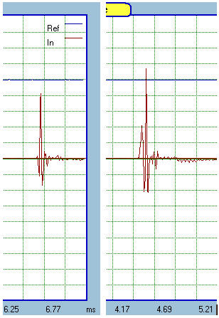

Verbal descriptions can be very misleading unless various recording are described in detail taking note of individual instruments. You can never tell what description is based on. But since you mention Klipsch, I have listed to their speakers many years ago, and yes, the impulse certainly looks like what they sound like.
BTW the imuplse for the Ariel seems inverted.
Attached is a two way design. The design was pretty much the same, but the tweeter alignment was different. The difference was very small such that I cannot remember.
But I really think that measurements are used to help determine how things can be improved. It would be necessary to look at various forms of data to determine how it might sound.

Hello Soongsc,
You remark is interesting in leading to the question:
for a multiways loudspeakers system what can be consider as the good polarity of the pulse reponse?
I think that the pulse response as shown by Lynn possess a good polarity.
This is related to the audibility of the absolute polarity and to the non linearity of our human hearing. For what I read and what I experienced myself, due to the internal ear distortion the good polarity is the one that lead to the least compression of the part of the pulse response corresponding to the frequency lower than few kilohertz. In other words polarity of frequency over few kilohertz is unimportant.
With the pulse response of the Ariel as given by Lynn the part of the pulse reponse corresponding to the low frequency is clearly rising when the part (the narrow peak) corresponding to the highest frequencies go down.
A good solution for having during listening the polarity right (it changes from record to record) is to use an inverting polarity switch. On records having very asymetrical waveshape (saxophone...) the good polarity generally lead to a higher perceived level in the bass.
