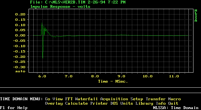

Excellent idea, Angelo. I plan to audition - and measure in the time and frequency domain - several different types, including the OS, and with and without 35 ppi foam (and other damping materials).
The poor time-domain performance (with long decay intervals) of traditional (multicell, sectoral) and diffraction (Mantaray, BiRadial) horns is well known inside the industry, and a large part of the reason that TAD and JBL keep time-domain graphs proprietary (they've owned and used TDS and MLS systems for at least 20 years, they just don't publish the data). The poor time-domain performance is also the reason that 1/3 and 1/6 octave frequency-response "smoothing" (and before that, "pen damping") is commonly seen in prosound specifications - the raw, unsmoothed data would look much worse, with many narrow peaks and dips due to energy storage.
On the other hand, distortion performance, efficiency, and available headroom are an order of magnitude better than direct-radiators - this the reason for the subjective clarity and impact of horn systems. By improving the time-domain performance (instead of pretending it isn't a problem, as has been industry practice for decades), you can have the best of both worlds. Not many people have been doing this - Dr. Geddes is one of the first, if not the first, to really zero-in and focus on this area.
P.S. The reason I criticize the top-of-the-line audiophile speakers is that many of them are the worst of both worlds - the low efficiency and limited headroom of small-diaphragm direct-radiators, combined with poor time performance thanks to ill-chosen diaphragm materials and inept crossover design. (Brand "W", for example.)
The two best reasons to choose small-diaphragm direct-radiators are compact size (better domestic acceptance and a more rigid, less resonant cabinet) and a simpler path to good time-domain performance. A big, inefficient, direct-radiator with poor time performance has the worst of all types of speaker design - and this describes the majority of ultra-expensive speakers at hifi shows.
When I talk of "good time performance" that has nothing to do with linear phase, but with how quickly the system returns to zero, similar to settling time in op-amps. Here's an example of what I consider good time performance:

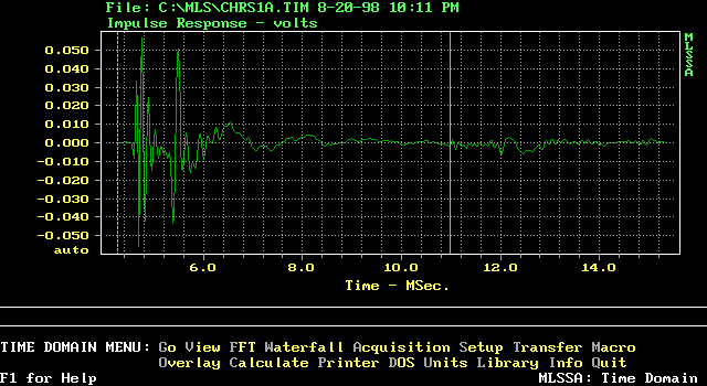

My only concern with these tests is that you get the waveguide right. I actually ended up making them because of all the people who tried them and said that they didn't work well. When I looked into it I found out that they hadn't understood the concepts and had designed the waveguide wrong (they "improved it") then when it didn't work well said that my theory was "no good". My results prove that if you get it right the theory is very very good. But it is easy to get it wrong.
Here's an example of poor time performance, with long settling times. The speaker sounds impressively "fast", dynamic, and exciting to listen to, but is also quite colored on pink-noise and symphonic music, and has a diffuse, vague image quality, with no rendition of depth at all. The settling time is about 3 to 4 times longer, and the MF and HF drivers are out of alignment.
