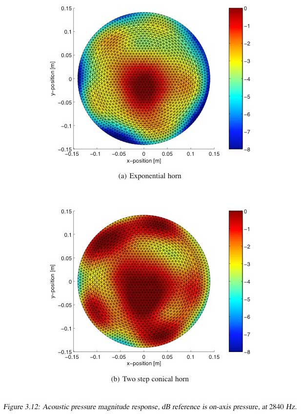

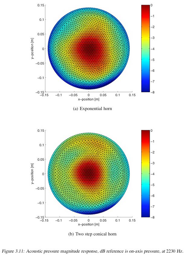

gedlee said:...He [Don Keele] was tell me that when they rotated the driver on a waveguide they got a different polar pattern! Thats when I came to realize that real devices were anything but ideal.
It would be of great interest to me to study where these asymmetries come from. Alas, nobody does advanced work like this anymore.
I would guess that the difference might be because the positions of the phase plug slots could be at different angles when the driver is rotated. If the slots were indexed so they fell at the same angular position no matter how the driver was mounted, the polars may not have changed when the driver was rotated.
It would be interesting to see. Maybe plug one of the slits and watch what happens, or use a different driver with a different phase plug to see the difference.
One thing that makes it appear as though the phase plug slots are responsible are the relative positions of the "hot" and "cold spots on the two horns. Notice below that they stay in approximately the same position on each horn. The amplitudes change, but the positions remain the same.
Interesting observation, which implies the asymmetry is coming from the driver, but where else COULD it come from.

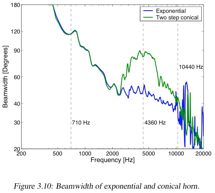

I just discovered many of the pictures in the Morgans thesis have reversed captions - the two-step conical horn is shown in Fig. 3.10 to have wider dispersion 2.2 ~ 11 kHz region compared to the exponential, as you would expect. However, that's not what the 2D graphs show, where many figures (including those in the Appendix) show the widest dispersion coming from the exponential horn. Compare Figure 3.10 to the 2D figures and you will see what I mean.
Having written and edited manuals for many years, I know from experience how common it is to get pictures, captions, and text references mixed up. It is a lot more common in technical publications than people realize, since the folks doing the artwork are not usually the writers - and it takes a very careful editorial eye to catch these errors.
