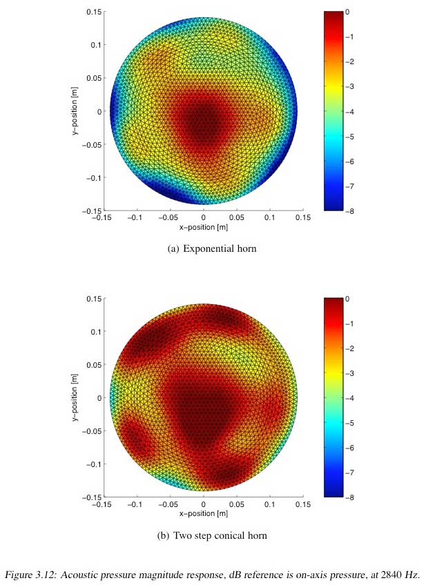

Sorry for pestering you about the HOM's - but I'm curious, and without question you are the most knowledgeable person to ask. Are these modes (highly) directional, or do they emerge from the entire mouth of the horn or waveguide and diverge smoothly outward?
Or does each mode point in a different direction, depending on the internal source of diffraction within the horn or waveguide (similar to the complex 2D patterns that appeared across the mouths of the test horns on pages 60 through 66 of the Morgans thesis)?
The Morgans thesis seems to show large throats have difficulty diffracting the higher frequency waves, this is pretty much what I thought before browsing through it. Will the equation that Dr. Geddes provided be the optimum curve? This would be interesting to find out. The only thing is that the equation did not address the fact that be final beam width is still frequency dependent and thoat size dependent.
Lynn Olson said:Sorry for pestering you about the HOM's - but I'm curious, and without question you are the most knowledgeable person to ask. Are these modes (highly) directional, or do they emerge from the entire mouth of the horn or waveguide and diverge smoothly outward?
The answer is more like the later. Each mode will have a different directivity from every other one AND this will change with frequency. Clearly a situation that would be difficult to analyze. Thats why I simply take the posotion that I need to minimize these undesirable attributes and not worry too much about the details of how they propagate. If there aren't any, or they have been reduced as low as possible, then how they propagate is academic. So I really haven't studied the directivity of them very much. Gotfried Bueler did some work in this a few years back at AES. He showed that they were indeed complex in the patterns that they radiated. His work was purely experimental.
soongsc said:The Morgans thesis seems to show large throats have difficulty diffracting the higher frequency waves, this is pretty much what I thought before browsing through it. Will the equation that Dr. Geddes provided be the optimum curve? This would be interesting to find out. The only thing is that the equation did not address the fact that be final beam width is still frequency dependent and thoat size dependent.

The answer is more like the latter. Each mode will have a different directivity from every other one AND this will change with frequency. Clearly a situation that would be difficult to analyze. Thats why I simply take the posotion that I need to minimize these undesirable attributes and not worry too much about the details of how they propagate. If there aren't any, or they have been reduced as low as possible, then how they propagate is academic. So I really haven't studied the directivity of them very much. Gotfried Bueler did some work in this a few years back at AES. He showed that they were indeed complex in the patterns that they radiated. His work was purely experimental.
Your informative reply is very much appreciated - I had a feeling that if the frequency of the Morgans' plot was swept, the GIF would have to be animated, and the hotspots would move around quite a bit. What's a little weird is the five-pointed star pattern also appears faintly in the exponential test horn as well, which raises questions about slightly asymmetric mounting of the compression driver.

It was the non-axi-symmetric results that were the most interesting to me. When I did the HOM solutions for the OS waveguide, I assumed axisymmetry and always wondered about this. The reason is that the non-axi-symmetry modes occur at frequencies well below the axisymmetric ones, so they are a more seriuos problem. Theoretically they should not exist in a purely axi-symmetric system, but Morgan shows very clearly that they do exist. How this happens is most curiuos indeed.
Its a real mystery, but one that I had a lot of evidence to suspect would be present. I first realized this after a conversation with Don Keele. He was tell me that when they rotated the driver on a waveguide they got a different polar pattern! Thats when I came to realize that real devices were anything but ideal.
It would be of great interest to me to study where these asymmetries come from. Alas, nobody does advanced work like this anymore.
