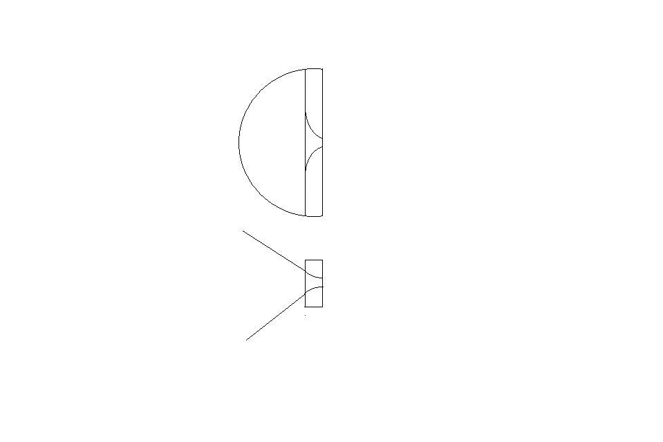

There's some point or purpose to doing a 180° CD waveguide?
Is this a waveguide ?

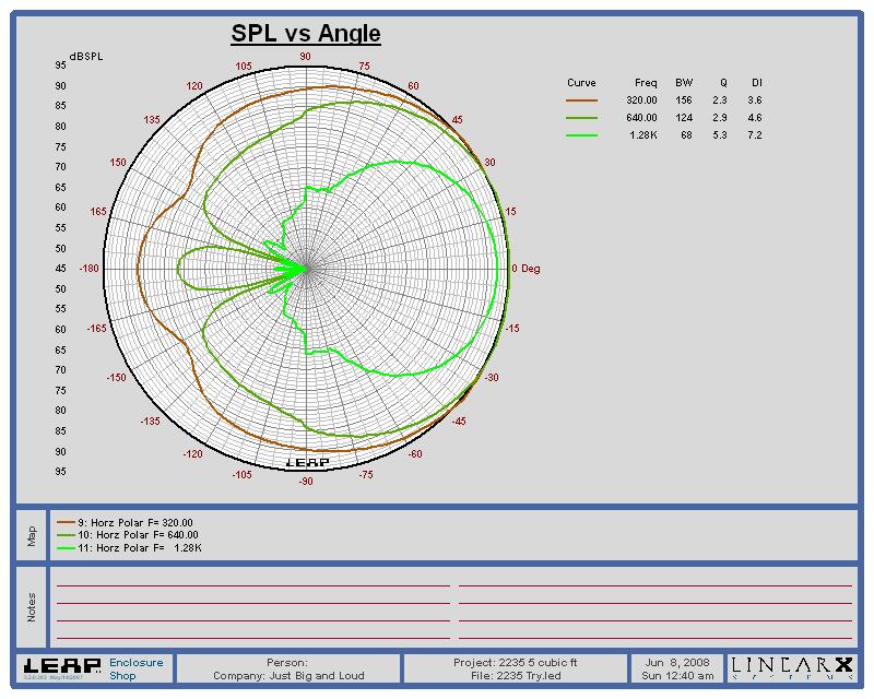

Robh3606 said:
Hello Zilchlabs
Here's what a 15" 2235 looks like in typical reflex box.
Rob🙂
Thanks, Rob.
Seems like JBL knew what they were doing with that woofer in 4430.
At 320 Hz, it'd take a ~160° CD horn or waveguide to match up.
While I can conceive of applications where that might be appropriate, normal listening environments would not be among them....
