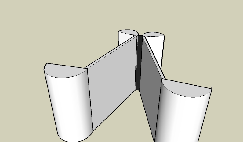

We tend to think of planar and flat as the same thing, so I guess they are. But I sometimes think of a plane as being a shhet of constant coordinate and so for me flatt is the more appropriate. But yes, in this discussion they are the same thing.
A ribbon is a flat source, but its not round, so OS doesn't apply. There are minimum diffraction waveguides which can be made for a flat rectangle. Why is non-axisymetric a plus? I always thought the opposite. I agree that the beaming is a downside, but in a proper waveguide even the ribbon would not beam.
Right I know that it isn't round. I'm thinking of using a line 32" tall in the WG.
I was thinking of following the OS profile in a square. I uderstand that it may not be ideal, but if it were oblong, like if you were to take your WG and stretch it out so that the throat was 2" wide and 32" tall, this should be close to optimal no? Obviously the throat would need to line up directly to the radiation holes on the driver, which are not square (they are rounded). This is however far beyond the ability of google sketchup. . haha
So for now I'll play with the concept of a square one.
Like this, this one shows only the horizontal axis, and is only a crude approximation of the OS profile, just for the purpose of entertaining the concept.
FWIW, I have built some test horns that are 50x30, one foot deep, and they are sounding very good with 2 B&G Neo 8s in each. I want a larger vertical coverage area than the 2 will offer so I'm looking at 4 per side.
Testing and listening to the ones that I have built, it seems that the loading (or guiding) is mostly on the horizontal axis, but I need to run some tests to confirm that.

Yes, what you have drawn will only control in the horizontal plane, the vertical polars will be completely uncontrolled. It will be very difficult to do any form of directivity control for a line source in the plane of its length. This is just fundamental physics.
You need to start with a fairly compact source to get good directivity control and once it starts to get large in any dimension then control in that dimension begins to degrade. The best control therefor comes from a elliptical aperature of the desired area. Circular is second best, best for axisymmetric. This is why I don't use a line source. This is also why I use a 1" throat instead of larger. The smaller the throat the higher the HF control can be maintained. A 1" can just get to 16 kHz or so, a 2" about 1/2 of this. The 2" necessitaes a crossover somewhere between 2 - 8 kHz. A very bad place to put a crossover IMO. There is simply no way to get one that is not highly audible in a critical range.
