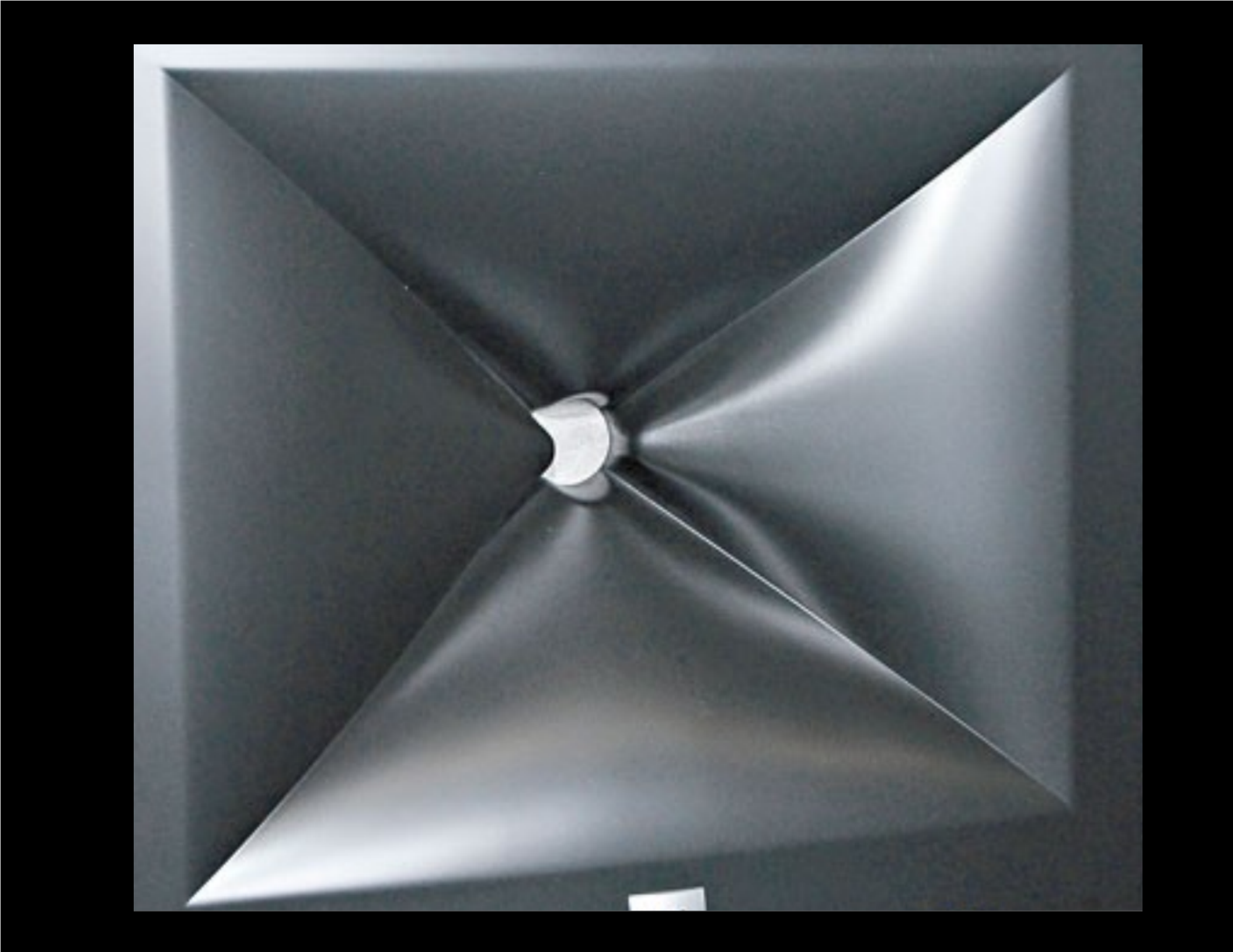

Wide dispersion seems the be due to total wave front chaos induced by an 'aggressive' horn throat geometry.
This design approach would appear to be the antithesis of that of an OS horn.
Can you say more about the wave front chaos and any audible consequences?

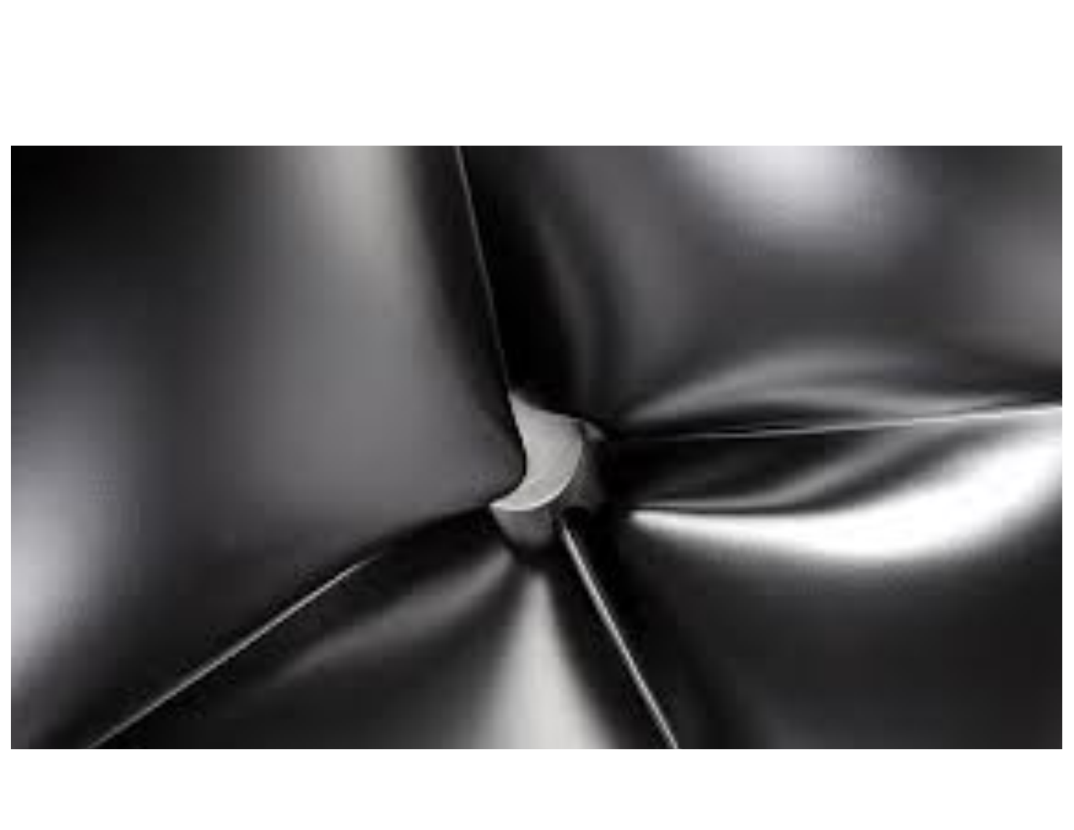

First, a brief description of the horn geometry:
The horn throat is formed by cylinder with (4) V-shaped notches cut into its end forming two horizontal points that are bent inward towards the horn axis and two (vertical) points that are simply rounded off. JBL product engineering staff collectively call these prominences, "knuckles". This profile is then extended outward in a radial fashion to form the horn body consisting of for expanding convex 'cheeks' bounded by diagonal 'trenches'.
Second, an attempt to describe the diffraction process that accounts for the wide dispersion:
At any given instant only a portion of the outbound wave front escapes the cylinder to be diffracted over the knuckle (slot) edges and allowed to travel down the trenches. This geometry accounts for the wide dispersion characteristic exhibited by the horn up to and above 10kHz. However, as part of the diffraction process, back-waves are most certainly being generated that travel back down into the compression chamber passages and collide with outbound waves. JBL claims that horn geometry sufficiently mitigates the attendant interference (chaos) that is occurring there.
At any given instant only a portion of the outbound wave front escapes the cylinder to be diffracted over the knuckle (slot) edges and allowed to travel down the trenches. This geometry accounts for the wide dispersion characteristic exhibited by the horn up to and above 10kHz. However, as part of the diffraction process, back-waves are most certainly being generated that travel back down into the compression chamber passages and collide with outbound waves. J...........
At this time, I have not been able to obtain design details beyond those provided earlier in this thread. I suspect, the response ripple will be hidden by the 'smoothing' of any graph published by JBL.
Hello whgieger
Well there is no cylindrical cavity in front of the throat. At least I don't see one. The 4 channels go all the way to the throat. Without a uniform conduit back into the throat how are the reflections going to get back there in a uniform manner. The way I see it the channels act to break things up and randomize the reflections back down the throat. It is also a very rapid flare rate which is also going to help matters.
Just floating this out there, what do you think??

More Choas
Rob,
We must be looking at different pictures of the same horn. The throat is cylindrical with exception of the horizontal knuckle intrusions ("points bent inward") as described before. The rest embellishes, the albeit brief description provided. The geometric portion simply provides a scaffold to further describe what is going on here acoustically. I minimized my comments here because they represent nothing more than a SWAG as characterized before.
Only the designer Sprinkle, witness to the lab data, knows for sure.

Hi whgeiger,
Looking at the figures You have send us in the:
http://www.diyaudio.com/forums/multi-way/103872-geddes-waveguides-709.html#post4052427
especially the second one, mentioned V-shape slits, as I have said reminded me of K-coupler, and if the height of the slit is about 1.5 inch, that would correspond to the frequency from the 2300Hz and up, expected over 20kHz, but from the M2 figures it seems to me that there are present another 4 K-coupler perpendicular to the horn axis whose slits are "looking towards" the listeners, or these graves behave as some kind of reflectors....
May one vertical slit K-coupler is coupled with the horizontal one K-coupler , totally 4 pairs positioned on the horn diagonals.
Unfortunately all of that is just "guessing"

I know that if I were to randomly modulate the mouth edge that this hole would get smoothed away. One could take this same concept right down to a diffraction slit. But rather than a "random" situation, enough "regular" diffractions of various kinds are created to create the same net effect. The end result looks "cool", is patentable and no one needs to know that a random design just might work as well. It looks carefully implemented, as if each facet had a function, and they do, just not a coherent one. The idea is to smear the results.
Audibility, that's anyone's guess. SWAG away.
My SWAG - a lot of smaller randomized diffractions would be less audible than a single one of the same net power. But it could be more audible than a single one of less power. That's the $64,000 question.
SWAG: Perhaps the wrinkled shape at the throat is intentionally designed to break up a planar wavefront, producing an incoherent wave by the time it emerges from the horn? Effectively, the horn analog of NHT's multiple-resonance transducer. As you mentioned, the exact opposite of a OSWG.
