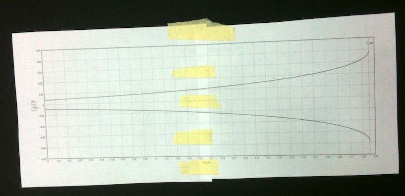

It will be a close to the circular shape, but with 24 leaves polygon... 🙂 (not the rectangular)
for 16 pieces of leaves, mouth end is too wide, and will be maybe too rigid to bend
and for 32 pieces, it is a too small length at the horn throath to manipulate with fingers...🙁
So I think 24 will be good.

Believe or not, it is not simple at all to calculate one "Leave" for desired horn shape
and then when bend all - to acheive right horn...

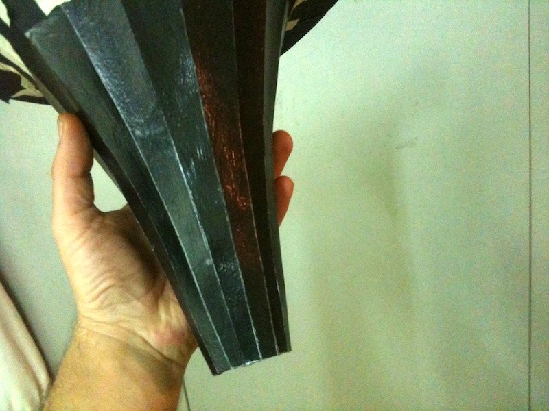

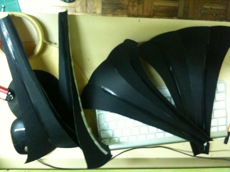

these pictures are from 16 leaves
black paper exp-hyp (T=0.68) horn...
the area shape is approaching to circumference.
that can be seen with sketching simple rectangular inside the circumference
And when it going to 8 side polygon, again dividing to
16 it is hard to draw. With 24 or 32 leaves it is almost full circle
And calculated diffefence in area are minor.
But I can calculate for even number, why not? 🙂
