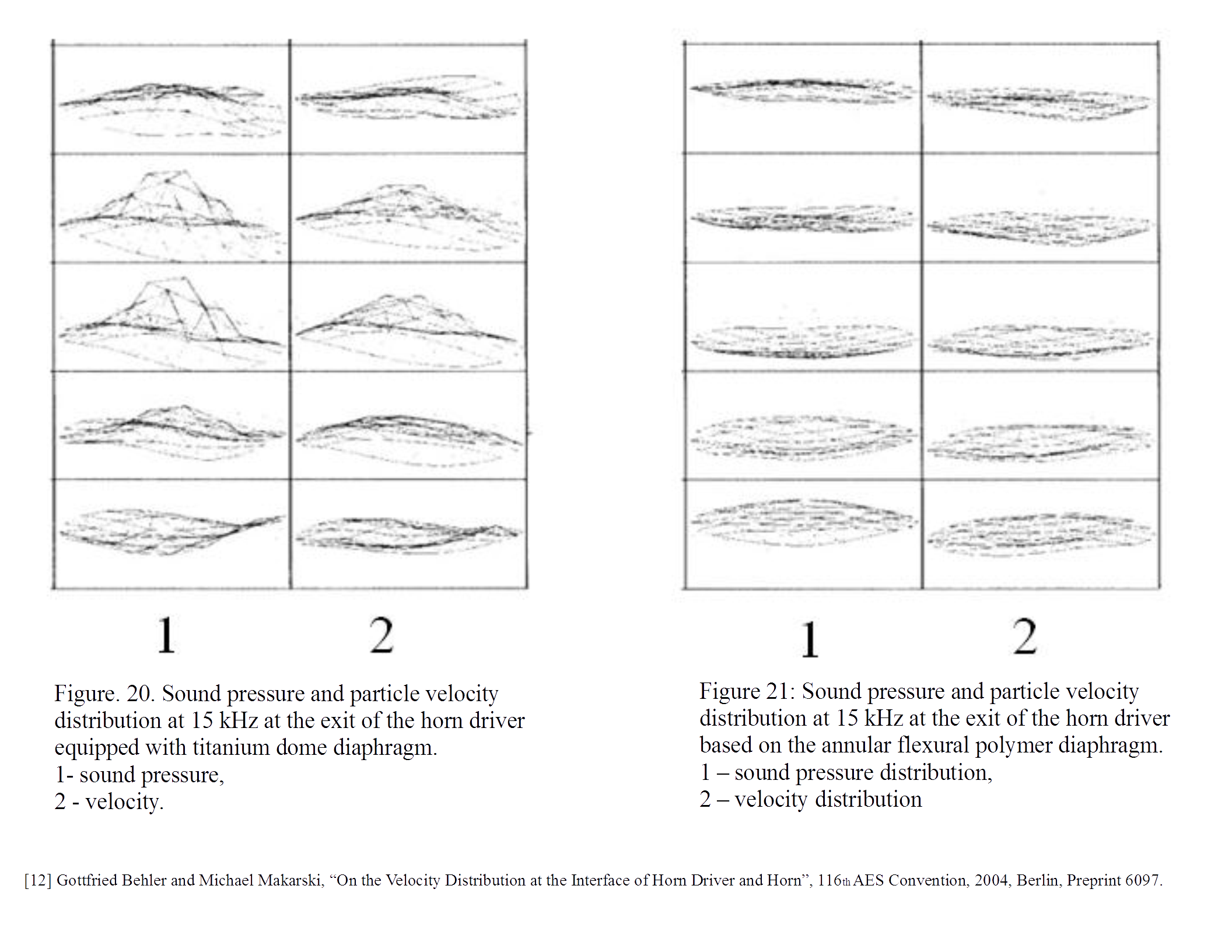

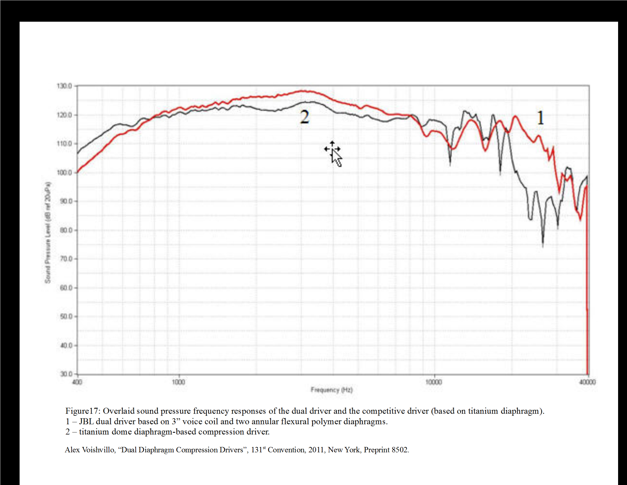

There is no transition in the operation of the ring diaphragms in Voishvillo's design [1] (JBL D2 Dual Diaphragm Compression Driver), they both operate in opposition to each other over the same frequency band. The design is meritorious as demonstrated in part by the PWT frequency response graphs [2], and particularly the shapes of wave fronts exiting the driver as compared in charts [3]. These were generated using the method presented in paper [4].
It is apparent that some performance potential has been traded for the value engineering introduced into JBL’s D2 production models.
Keeping the compression chamber and phase plug passages air-tight, looks to be a potential problem, due to the multiplicity of componentry required to enclose them.
WHG
[1] Title: Dual Diaphragm Compression Drivers
AES E-Library Dual Diaphragm Compression Drivers
[2] Figure 17 (JBL-D2-PWT-FR.png)
[3] Figures 20 & 21 (JBL-D2-WFP.png)
[4] Title: On the Velocity Distribution at the Interface of Horn Driver and Horn
AES E-Library On the Velocity Distribution at the Interface of Horn Driver and Horn
WHG
