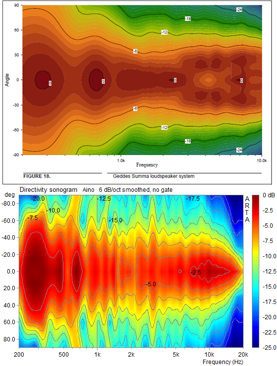

Gedlee Summa uses a horn and cone bass to achieve controlled directivity. Sonogram from Earls white paper vs. my AINOgradient (dipole and a small horn) - both achieve very similar directivity as KS-483 by different "mechanisms". DI is much higher that KS-483. Both sonogarams are not-normalized.
Notice - different scales and measurement conditions - not exactly comparable!
I would agree with that.
If you have raw data in a reasonable form I can plot it in the same format as the Summa.

Maybe I should call my goal HDICD for High Directivity Index Constant Directivity.
What you've achieved so far is HDICDBOAHF – High Directivity Index Constant Directivity But Only At Higher Frequencies 🙂

More like Mid freqs as the DI is fairly constant above about 700 Hz. Not much has a constant DI below that and as I have said so often, I don't think that it matters as much at the lower freqs.

Kimmo Saunisto's KS-483 seems to be well-designed, but I don't buy the directivity he shows. I strongly doubt the microphone distance was fixed.
Thank you Earl, but that outdoor measurement is not up to date any more. I will soon be able to publish measurements with Neo8-PDR. According to proto measurements it will make directivity even smoother between 800-4000Hz. Because of the weather I can't do outdoor measurements now.

keyser, Kimmo is a very sharp guy and careful with what he shows. I believe that it was done indoors and with variable gating up to 300ms in the low end (I don't know about lsp) He has said that he was really surprised when he saw the results and the speaker works extraordinarily well in a room! I believe that the magic lies in the wide bafle and wisely chosen xos. Directivity control is good but DI is lowish though.
Generally this thread is bubbling about what kind of form(slope) and level the DI/Fq curve should be. The right way to measure and plot is important if we do comparisons, but for us amateurs we must accept differencies in methods and scales.
And then, DI doesn't tell much alone. A dipole has high DI but strong radiation bacwards unlike horns. They sound different in a room even with exactly same DI curve.

A dipole does not have that high a DI, about 6 dB. 9-12 dB is what I would consider "high". No DI does not tell us everything, it is one measure in a number of important ones. But a bad DI has been shown by Toole and Olive to be undesirable - hence it is an important criteria.
Did you realize the lowest line is 120° (240° pattern)? That data plugged into most of the sonogram-style graphs around this thread would just be a box of red.Kimmo Saunisto's KS-483 seems to be well-designed, but I don't buy the directivity he shows. I strongly doubt the microphone distance was fixed.
