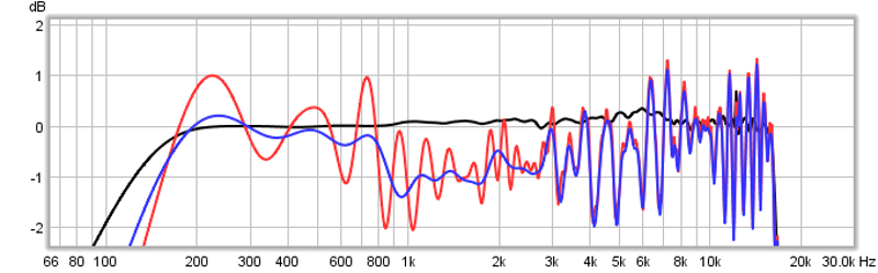

This is clone of Linkwitz's Pluto speaker; a fully active DSP controlled implementation:
Tweeter is 2" Peerless full range mounted in end of 12" long pipe that is filled with damping material and left open at the back. Tweeter is about 3" above edge of SEAS L16RN-SL, manufactured for Linkwitz. Crossover point is set at about 1kHz.
Tweeter is set to ear height. Tweeter axis is tilted about 5° up from horizontal.
Measurements for correction were done at 9" horizontally from lower edge of tweeter cone. At this distance first room reflection is from floor and is about -42dB from direct sound. Correction is done using entire IR employing Kirkeby inverse.
Measurement of corrected system was made from 9". Additional measurements of corrected response were made 15° below reference position, at 30° horizontal by 30° vertical, 45° horizontal, and 90° horizontal; all at 9" from tweeter center. Measurement was also taken at ear height from preferred listening distance of 42".
Windowing is Blackman-Harris 7 term 12ms for left and right of window center.

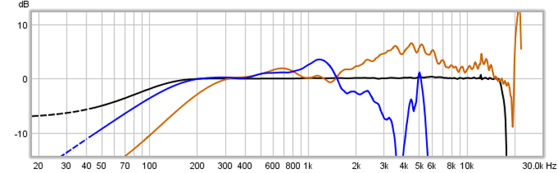

Here are overlays of raw responses of woofer, tweeter, and corrected system:

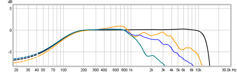

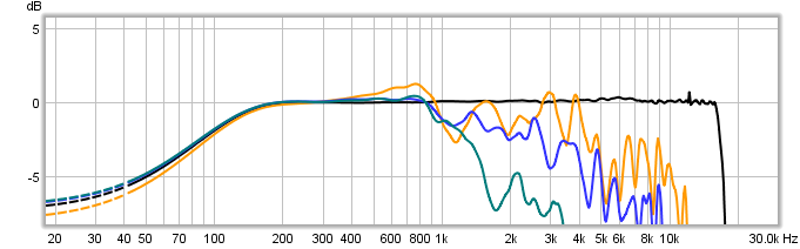

Overlays of corrected system and off axis measurements:
Ripple off axis is primarily due to diffraction of tweeter and is superimposed on overall directivity of tweeter.
In above plots no smoothing is applied; 1/3 octave smoothing is revealing of tweeter directivity:
The 30° vertical component of 30° horizontal by 30° vertical measurement reveals minor lobing behavior at 1kHz.

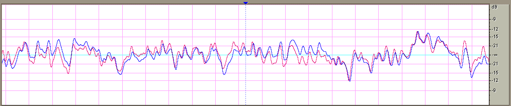

DSP based Pluto Cone produces highly recognizable square waves on axis, off axis, and at listening position from 70Hz-4kHz.
Accuracy extends to much less demanding waveforms such as percussion in music as well. Here is percussion of drum being struck. It is about 94ms of recording from CD. Top track is recording on CD, lower track is recording of speaker playing CD:
This is 10ms zoom to cursor location in above waveform:
Measured performance of accuracy is exceptional. Am I hearing what is on CD?
Sure looks like it. Does it sound good? Yes.

I agree.I superimposed both 10 ms graphs:
There is a periodical error of about 4 ms length. You've got something wrong in the 200-300 Hz range. 😛
But getting serious: The reproduction is impressive. 🙂
However, this has a limited bandwidth representation. It would be interesting to see a more complex music passage, and be consistent within 15 degrees off axis, that would be IMPRESSIVE!
