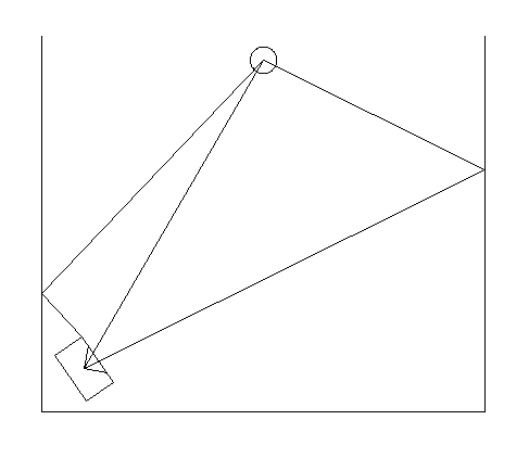

I find that my first opposite side reflections need to be absorbed. At first I didn't try this because I assumed the opposite ear would separate the reflections.
My sides at this point are different, one diffracts more and one is more reflective. They are 8ms from the direct. They throw off imaging and the reflective side contains a considerable amount of energy.
It occurs to me that the first opposite reflection path is more on axis that my listening axis is, and this concerns me.

No. The reflection points for first same side and first opposite side are in different locations (four side absorbers needed in total).Allen, when you absorb opposite reflections, you also absorb same side reflections. I wouldn't discount that little tidbit in what you are hearing depending on exactly how you are doing it.
My point is simply this. My first same side reflection comes off the front baffle almost perpendicular to it. My listening axis is at around 20 degrees, and the first opposite side reflection leaves the front baffle at 5 or 10 degrees from it.
Therefore, although the first same side is close in time to the direct, and it is also the same ear, the energy is lower. I find this makes each of these type of reflection just as necessary to deal with as each other, in my case. FWIW, subjectively the first opposite side reflection was less damaging to the sound, in and of its own, but the brute force of the magnitude made it a bigger issue.
Can you give us a little diagram to illustrate this?
The paths we call "the first reflections" (no matter which) must always be right on axis with listening position, no?

None the less, the picture is worth a thousand words. I'd say pull you speaker out from the wall and if you have a narrow directivity WG, that reflection shouldn't be too much of a problem in the range of the WG. That said, I'd say get absorption up along that front wall and beside the speaker like a short "U".

I think your graph shows and interesting issue to consider. Within the directivity path with it's first reflection off the opposit wall, the strength of the reflection might not be less than that caused by out-of-beam first reflections.Aren't we discussing speaker directivity and the response of waveguides at various axes?
So now, the reall complication would be profile of beam and roll-off and it's suitability for different listening arrangements.
