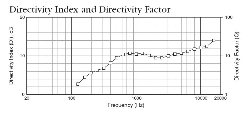

OK but what's happening up top?? Here is the DI curve for the JBL Screen Arrays you mentioned. In a perfect world the directivity would be a straight line. You can see that the bass starts at a very low number and then the DI increases as you change over to the waveguide in the mids and top end. Take a close look above 2K or so. The number is getting higher and above 10K it starts an abrupt change, you can see the hook at the end.
A CD waveguide would have a straight curve like the older 2360 Bi radial horns
http://www.jblpro.com/pages/pub/components/23606566.pdf
That horn family are 2" throats and you can see above 10K they simple loose control.
The on axis response is another matter entirely and can be flat either by the increasing DI from the horn, Electrical compensation or a combination of both.
Rob🙂
Note that the 2360A has been replaced by the 2360B.
http://www.jblpro.com/catalog/support/getfile.aspx?docid=174&doctype=3
There is a slight improvement in the 16kHz polar but the main improvement is in response smoothness at 1kHz. I'd say that, outside of this forum, most of the users of 2" throat drivers use them for their very necessary increase in power output. 500 or 800Hz crossover points also work very well with 15 inch woofers in a theater environmnet. There are plenty of 2" throat drivers that work well to 15-16kHz so there is little compromise at the top end.
