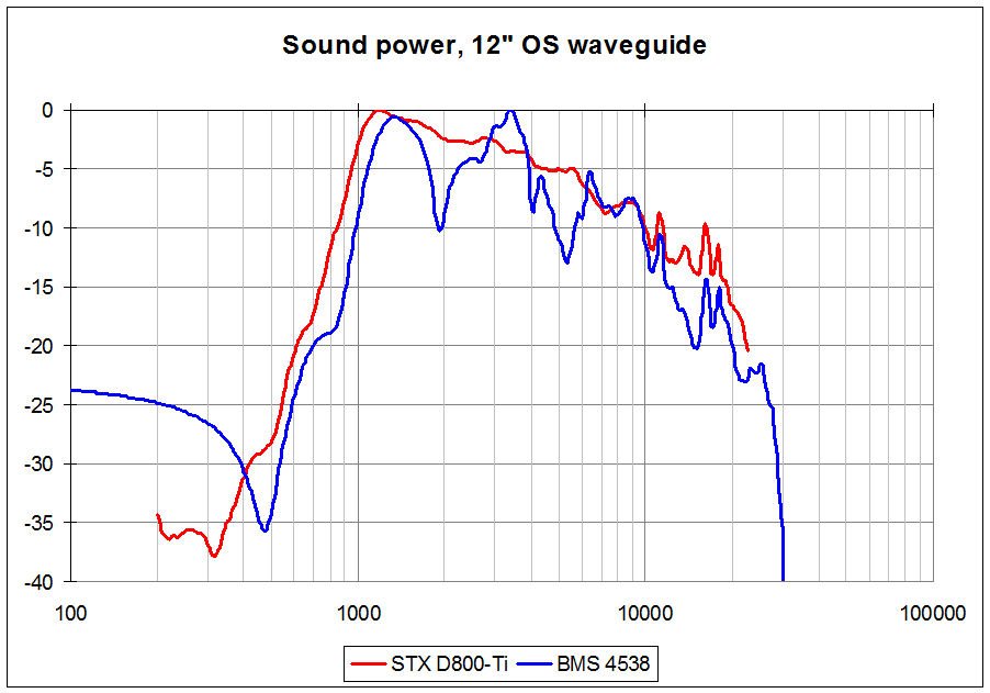

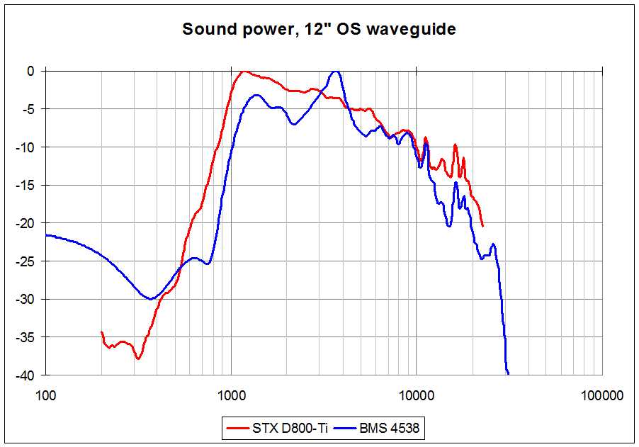

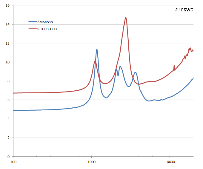

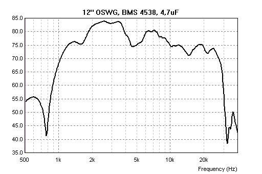

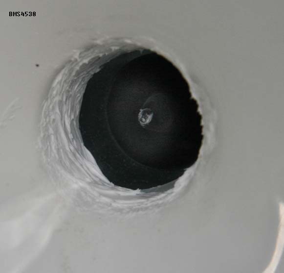

A comparison between drivers: STX D800-Ti and BMS 4538 that looks to be faulty. It goes up to 25kHz and does not ring like STX (titanium) or BC DE250 (also mylar).
