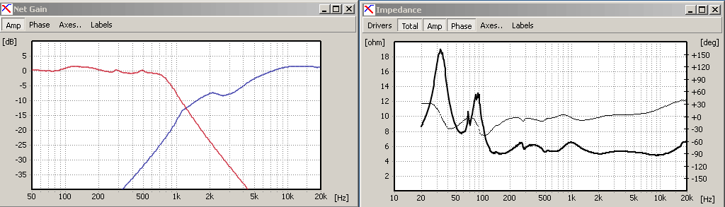

The ESP12 is obsolete and no longer available, and I no longer have data for it. One hasn't been built in more than three years now.
The Abbey is similar to the ESP12 and its impedance looks a lot like what you have posted except that its a single LF peak not two as in a ported enclosure. The Abbey impedance would not drop as low as the 4 ohms that you show, it would be more like 8 ohms. This is just the input impedance level of the pad (a two resistor voltage divider). You can make it pretty much anything that you want. The HF impedance is basically nothing since it gets swamped out by the HF pad.
Surprisingly I cannot damp driver resonances with pad and LCR at the output. Only with a LCR combination at the input and output and only if I find values by trial and error.
Tell me about it. Took 2 notch filters to get an impedance that's workable enough for the CD EQ to work. On the upside, the notches make the rest of the filter simple, I'm actually squeaking by with a 5uF cap and a level matching resistor. Sure, the power handling won't be super, but it's pretty darned clean at my levels, and the (modeled) phase behavior is excellent.
Crossovers for compression drivers are never simple.

What about analog EQ w/time delay & CD compensation, as many readily available pro units have.
JBL uses compensation at the input which can be waste of amplifier power. For valve amp ok but for solid state - questionable? I've spend many days and still haven't found satisfactory result.

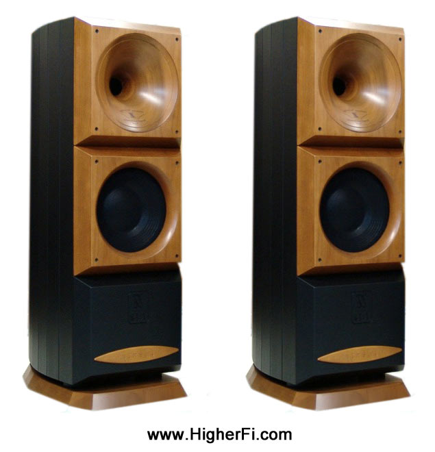

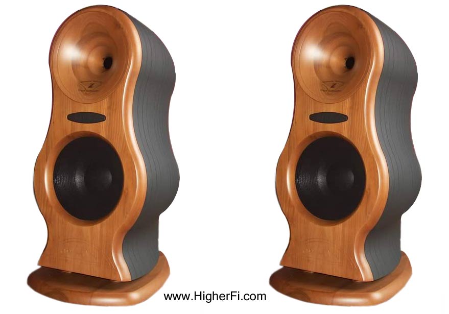

I saved that picture of the curved set more then a year ago saying I would love to build that some day. Of course I will never be that good.
Ferrari vs. Chevy(Geddes lives in Michigan).
I would expect about the same comparison in cost, but not in performance.
That's quite a gap between the WG and bass driver.
Beauty's only skin deep. Ugly's to the bone. Beauty soon fades away, but ugly holds its own.
Dan
Dan
I have listened to both of these, I'm sure you can beat them hands down in fidelity. However, there are still some sonic qualities many customers like about these as well as the looks. BTW, the hi end audio show here is only a few days away.I would expect about the same comparison in cost, but not in performance.
