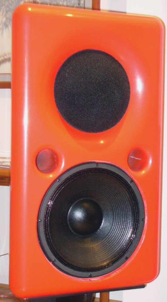

I just took this picture - its terrible, but at 100k and a hand held camera thats just about as good as it gets.
Earl,
Well my wording was unclear - I was talking about two different things.
I've opted to extend the bass down into the mid to lower 30's (depending on positioning and room acoustics and amplifier output impedance), so my current models can be used without subs in most cases - but my efficiency is lower than yours. My little four-piece subwoofer system is mainly aimed at owners of planar speakers with insufficient bass extension (since the subject of subwoofers came up, let me mention that I'm using Earl's asymmetrical multi-sub approach with his permission). I agree that multiple subs spread around the room is the best way, but it's a tough sell in most cases. Dipole owners on the other hand are usually frustrated enough with conventional subwoofers that they're more open, and dipole owners have already accepted the idea that their speaker system is going to dominate the room.
The bipolar speaker isn't a new type of bass loading - it's just two sets of drivers, one on the front and one on the rear of the box, with (in my case) some vertical offset to the rear woofer to stagger the distances from each of the woofers to the room boundaries The main purpose of the controlled-pattern offset bipole is to increase the relative amount of late-arriving in-room reverberant energy without increasing the early (pre-10-millisecond) reflections, so they should be positioned to allow sufficient time delay before the reflected energy from the rear-facing drivers arrives. I am a strong believer in a relatively late-arriving, well-energized reverberant field. I use the same 45-degree toe-in that I learned from you. This is the speaker I showed at RMAF last October, which I think panomanic heard.
Duke
