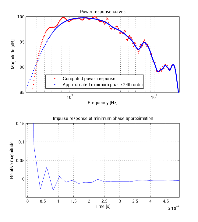

Is there any other way of power response estimation than average in freq. domain? The drawback of average is that phase information is lost. I did an experiment with Matlab to get minimum phase response of such a "power average" curve and presenting the results. I'm not sure if this makes any sense since horns aren't minimum phase devices (as far as I know).
The question rises equalising filter domain. Stay in frequency domain with multiplication or go to time domain with some minimum phase approximation?

Power averaging removes horn reflections so convolution in time can make some sense?

Well I thought horn is non-minphase device because of higher modal wave propagation (internal reflections, diffractions) in contrast to direct radiators. With pressure averaging we lower the magnitude of reflections in total transfer function thus then the response is more minimum phase.
