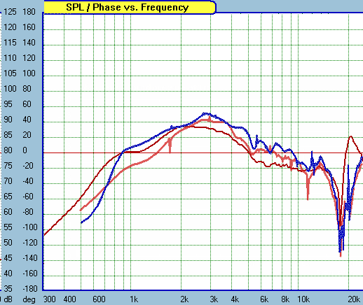

Update. From a whole bunch of data from sims, I decided that the configuration for this data (23cm diameter at baffle blending edge) is interesting enough to test. Pretty close to an OS. What really worries me is that manufacturing tolerances seem pretty critical.
Finally got time for a little rough measurements.
0~45 deg in 7.5deg increments. As we can see, not quite the same as the sim. So we can explore a bit deeper to see whether differences between model and physical configuration plays any important effect.

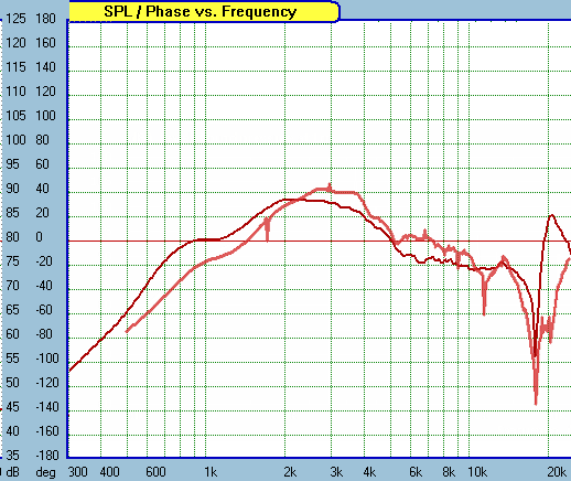

Modifying the lip of the sim to cut back 2cm abruptly, not only a hole is created, but also the deep notch location is closer to the actually measured location. This is quite an interesting find.
Since the model has to be axisymmetric, totally accurate sim is not possible for comparison. But, it seems termination of lip after 180 deg is also critical for a good response. So the narrowest baffle might not be the best kind of termination.

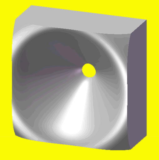

Can you sim a spherical curve transition from tangent and continue through 270 degree rotation? (ie., 225 degrees from axis) :nod:
In the past, I have simmed not only that, but actually free standing 1M in front of baffle. The results were not that accurate. But What would be interesting is to do a little bit of lip and determine how lip curvature might effect response. This is what I plan to do in the next step. At least, up to now, the WG and throat section seem to be adequate enough.
