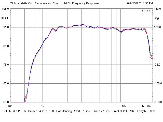

Here are four BMS 4555s on JBL PT-F95HF. They'll mate with any of the half-dozen available variants of that 1.5" throat waveguide family. You do have to drill mounting holes in the flanges:
These were running on Altec Model 19 crossovers, of all things, 1.2 kHz....
Here's Brandon's measurements of BMS 4540:
http://sites.google.com/site/drivervault/driver-measurements/acoustic-elegance-td12m/bms-4540nd
Also on the Pyle waveguide:
http://sites.google.com/site/driver...-knock-off/frequency-response-with-bms-4540nd

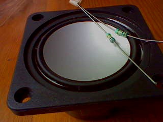

Oh, that looks very interesting. Is it possible to measure the diameter and depth of the diaphragm?Dont forget the possible lower xo point of a pro driver

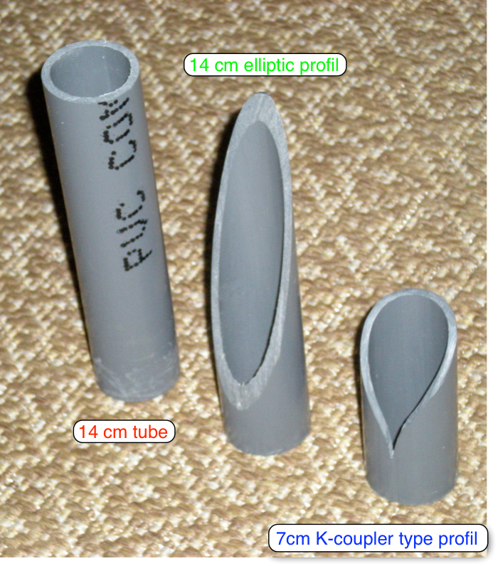

I have measured the quantity of acoustic energy which come back to the compression with 3 shapes of end tube:
I notice 2 things, the very good linearity of single tube and the very effective elliptic shape for the reflection (better than horn above 4Khz).
However, the directivity of elliptic shape is very special.
