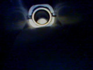

From following this and other related threads, its very clear that a throat like this need some careful work
Surely also in line with the latest posts in the matter of crutial flaws in a copy process
Funny thing
If I remove the screwon thread its almost exectly 36mm, which should fit a 1.4" exit driver
Only, those are awfully expencive
Sound like the problems are worse at lower frequencies
Is that a tendency to expect
That problems expands with lower xo point

I wouldn't say that the problems are worse at the lower frequencies, in fact I'd say its the exact opposite. When the "errors" are small compared to a wavelength they are benign, but when they get to be comprable to a wavelength they can be problematic.
