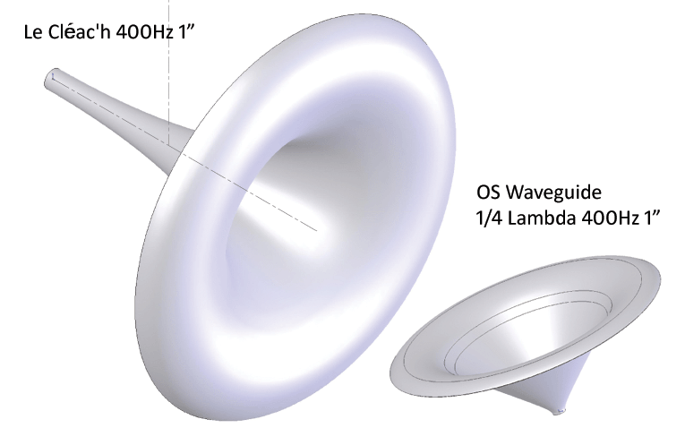

Very cool! We await the results. Are these 400Hz profiles for an 800Hz crossover point? There is a wide choice of good drivers to do that. Nice.
We have chosen Le Cléac'h because it's bit more universal so that you can cut it a bit for a variety of ordinary dome tweeters with exit port 30-35mm but still have 1" for compression drivers. On the picture 2" throat is marked with vertical line nearly in the middle of the horn. These small horns we can make from one piece. Later on we will try 100Hz horns with flat drivers.
I don't have any decent and cheap compression driver so can't design for particular model. Anyone tried <a href="http://www.tb-speaker.com/detail/1230_04/w1-1828s.htm">Tangband W1-1828S</a>?
OK, I see the 2" cut point. So you could try them with 1", 1.4" and 2" drivers. It's going to be interesting.

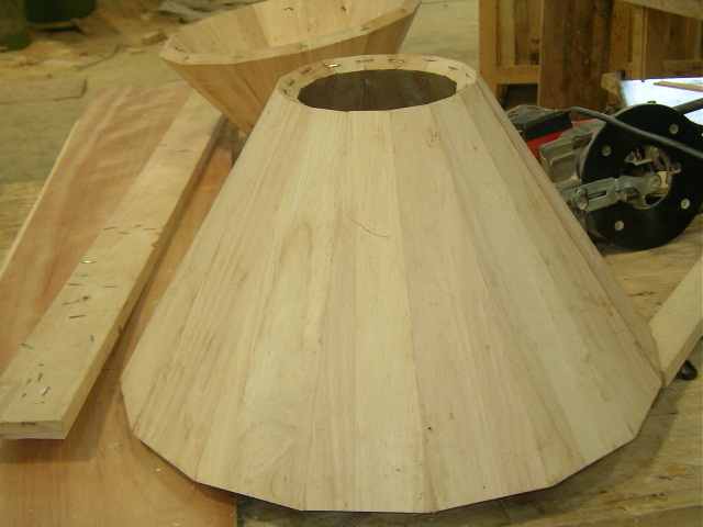

OK, I see the 2" cut point. So you could try them with 1", 1.4" and 2" drivers. It's going to be interesting. That's a strange little TB driver you linked to - never seen it. (BTW, your WWW button link isn't working - check the last part of the URL)
With 2" will be too short.

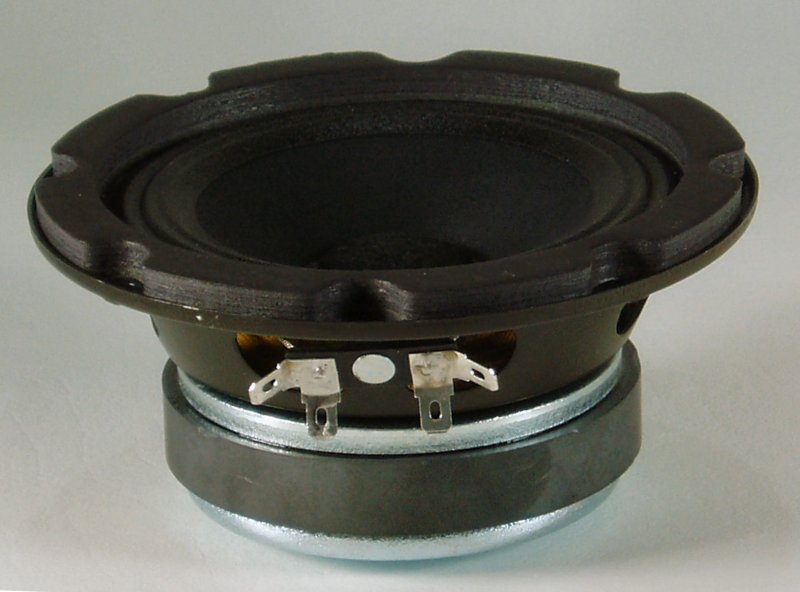

In the process of evaluating woofers for a Unity horn, I stumbled across one very unique loudspeaker. It's a paper-coned woofer with a fairly small diameter, and a freaken' huge motor on it. There are plenty of other woofers like that, but this one is neodymium/ferrite 😀
http://www.miscospeakers.com/SpeakerDetail.cfm?SpeakerID=319

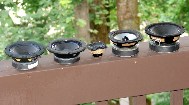

Here's a pic of mine, making a bunch of other midranges jealous 😉
Because of this goofy motor, the specs show that it can cover 350hz to 2khz.
That's pretty unique - I've never seen a woofer that could do this, normally you'd have to spend the big bucks on a compression driver to get that kind of performance.
It's only $30 too. Four of these at the apex of a 30" waveguide would cover the entire midrange, and they'd give you about 110DB with one watt!
