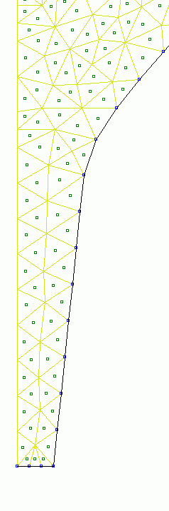

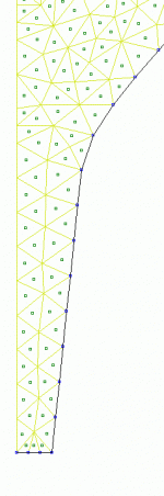

I said when I first saw those that I did not think that the throat looked right and asked to see it it more detail so that I could check it. This request was ignored. That is NOT taking "the same care" as you claim. That is ignoring a direct complaint about this care. I never checked what was done - thats not care, thats negelect.
Earl,
Checking back, I see that you did post a request. Sorry for not recognizing it. Here is a close-up of half the throat of the waveguide used in the simulation. Element length is no more than 1/6th wavelength at 8kHz. Blue rectangles are nodes, green rectangles are field points.
From what you write, it may be necessary to use a denser boundary mesh to get things right.
Bjørn
Bjørn
Kolbrek said:Earl,
Bjørn
Bjorn
First the throat seems way too long. I don't know the actual length of the throat in the DE250, you would have to get that data from B&C. I also don't have the actual data point values to check either.
If these sims are going to be used at "attack" a design then you have to be sure that they are correct. Jean-Michel is unfairly using the results IMO by showing only what he wants us to see. If he is getting these from you then it is only fair that everyone be able to see all the results that are available and concur with the process. Can you do far field polar amps? These are only near field and only single frequency, not really very enlightening at all. If you have trouble plotting polar maps then I would do that for you as I have this capability. I would just need far-field results of SPL versus angle and frequency.
And, yes, that is a very coarse mesh for a high frequency. One should usually have about six elements per wavelength. With what you have shown the HF limit of accuracy would only be 6-8 kHz. If the density is too coarse then you know that this will generate aberations that are not accurate and these aberation will differ from device to device, none of which is correct.
I also question the validity of going all the way back into the throat of the device since this is part of the driver NOT part of the waveguide. The waveguide cannot correct for the drivers deficiencies and different drivers will act differently. I suggest that the two devices be compared driver independent, i.e. just the waveguide/horn portion, without the driver. If this is a model of actual devices then why not just use actual devices? We have those devices and the driver, why not just compare them directly? Why the need for a model? Models are used when the reality is not available, but in this case we have reality.

gedlee said:If these sims are going to be used at "attack" a design then you have to be sure that they are correct. Jean-Michel is unfairly using the results IMO by showing only what he wants us to see. If he is getting these from you then it is only fair that everyone be able to see all the results that are available and concur with the process.
I'm not happy with the direction this discussion has taken either, to the point of regretting sharing these simulations at all. 🙁 I don't want to be part of this discussion of OS waveguide vs. Le Cléac'h horn. I did some simulations out of curiosity, not to make ammunition for an "attack".
Surely I could generate lots of data for a discussion like this, but I want to stay out of it. I don't have time for it.
I can't do it at the moment, but I plan to add this capability to my SW. I attach the far field field (3m) point data, for a fixed throat velocity, from the simulation I did in the "Beyond the Ariel" thread. It's a text file format, zipped because of size constraints. It should be fairly easy to interpret. It's the same boundary profile that I used for the field plots, exept that it is twice as dense, since the maximum frequency is 15kHz.
That's just what I said, 6 elements per wavelength (element size no greater than 1/6th WL at 8kHz), and 8kHz is the highest frequency used in the field plots. One will of course try to keep the size down, as computation time increases with the square of the number of elements.
