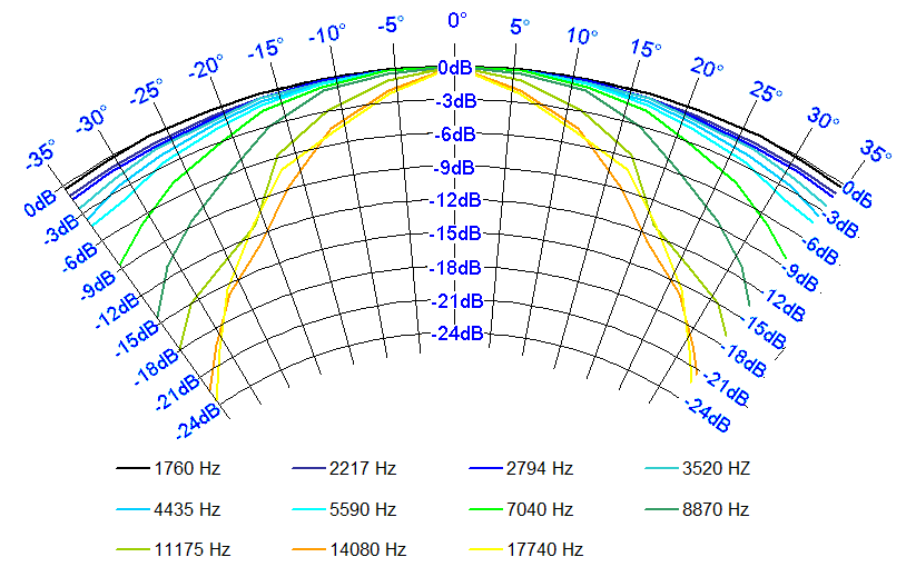

I yet published few directivity curves in one discussion you were an inevitable protagonist. You'll find them one more time in attached file to that message.
Never I did say that the foam impedance was "purely reactive" but only that it was "reactive", doing such I admit that it can possess a real part added to an imaginary part.

Why would you care about off axis impulse responses? You never do off axis measurements (or at least never show any) why all of a sudden the interest in off-axis?

Interesting graph. I would make two observations. It makes it abundantly clear that it is anything but CD, makes me wonder why you would be so intent in discussing it in a thread about a CD device as a goal. It also indicates that there will be a very narrow range of angles in which there isn't significant deviation from a relatively linear response. Equalizing it on any particular axis results in a similarly small range.

From the data shown, the foam is not doing that to reduce HOMs. It does have a filter effect as shown in the curves with and without foam, but it actually serves to diffuse the pressure wave front so that pressure is smoother throughout a range of angles.

I understand that point, however the goals seem to me to be in opposition. The goal of the OS waveguide/foam plug is, if I understand correctly, is a device that when equalized in the off-axis position and aimed as recommended will provide a wide coverage of relatively consistent response due to the characteristics created by the foam plug and OS shape for multiple listeners. All of that is separate from the HOMs, of course.
In contrast, the data as just posted by Jmmlc is antithetical to this goal. That is, his has an extremely narrow control area and cannot exhibit a similarly broad area of coverage in typical room listening environment. It certainly will not provide a similar room response.

As I have said before, the foam has no significant effect on the directivity, that is completely controlled by the waveguide. The foam is purely for sound quality and not directivity. You are correct in your understand otherwise.

I suppose that this will be argumentative, but I didn't see any insistence, only a comment that you had not made them, not quite the same thing. Having followed this thread, I couldn't recall having seen them in the past myself.
Either you missed my point or are side-stepping it. You now show quite explicit data of your own measurements that shows your design to be exceedingly highly directional and highly frequency dependent as opposed to the pattern desired in an OS waveguide as I understand it and that your design in no way has the properties nor even the goals put forth for the OS waveguide. It is as I said above, antithetical, not necessary bad. So excuse me if I am a bit puzzled as to your intent in the discussion. Are you trying to show some kind of superiority of design in some form over the OS waveguide concept or is it something else? Maybe you'd like to clarify that.
