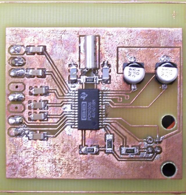

I also wanted to post pics of my latest little project that will eventually become part of the entire preamp project. It's a PCM2906 USB DAC/ADC. This was my very first attempt at SMD and I must say it came out quite well IMHO. I am now thinking of converting one of the preamp designs to SMD to save space...but thats another project for another day. As for the little DAC, it worked on the first try, and sounds pretty good. I know there but this was a nice project to try SMD on. The circut is straight out of the datasheet, the board design is my own. By the way these boards were made with the method I posted earier...those are some very small spaces...that is a SSOP28 package!
G, that is very cool! I have been coveting a USB DAC like that for a while now. 😀 Any chance you could send one of those too?
Did you do "flood and suck" to solder the DAC?

Russ,
Since I am etching some boards anyway I suppose I could throw in a DAC too. For the PCM2906, I used the "flood and suck" method as you mentioned. Just loaded on the solder then used a desoldering brid to pick up the excess. For the caps and resistors, I put a little solder one pad, melted it and applied the part, then I soldered the other end in place, didn't need a desoldering braid for them. Turned out ok I think!

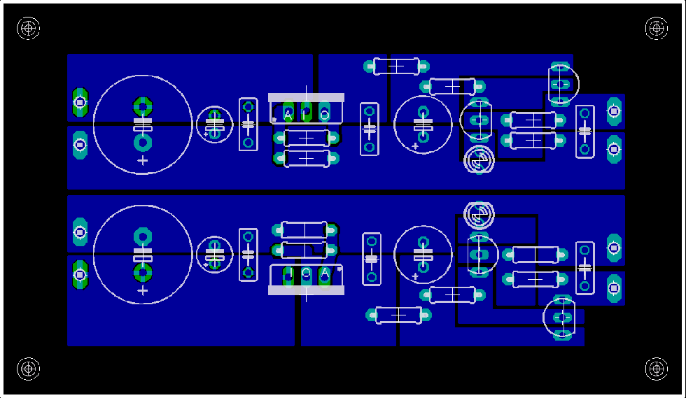

Since we are all looking for a PSU to go along with this preamp, I decided to design a board around the regulated supply on Nuuk's wesite. It seems to be getting posotive reviews, so I figured what the heck. I have arrached an image of it below. If you want to read about it you can see it here
http://www.decdun.fsnet.co.uk/gainclonepre.html#gcprebuffer
As you can likely see t is a simple LM317/337 based regulator for the first stage, then a discrete regulator for the second stage. I could have goined the grounds together, but decided to keep them seperate. I plan on using an Amveco PCB mount toroid that has split secondaries along with dual bridge rectifiers. I know this is total overkill but hey why not.
I made sure that the regulators could be heatsinked, in case you have rather high voltage on your secondaries.

Nice!!
I like it, I always like overkill, theres always a little extra if you need it, which you invariably will 😉
