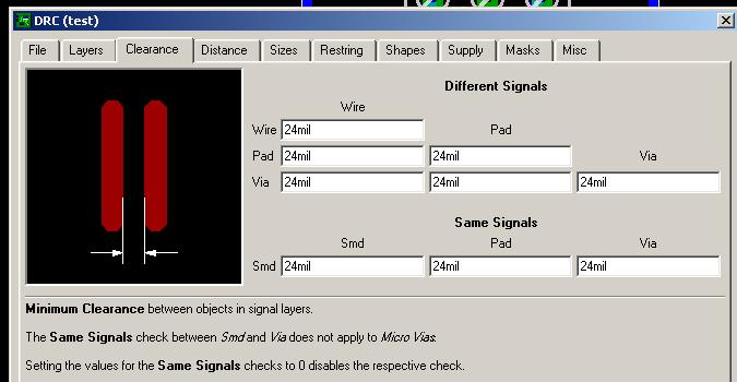

BrianDonegan said:Trace size was okay from an etching standpoint (I used photo etching), but slightly large can't hurt.
I can see how it would be OK for photo etching but for laser printer method its easier with bigger gaps.....still not massive, just a tad bigger helps. You can set that bit here:
maxw said:I've found the default design rules for eagle not so suitable for DIY etching in some situations. I have changed the default distance between ground planes and traces but haven't worked out how to get the resister and small capacitor pads a bit bigger......if anyone know how then let me know![]()
As far as I know the way to adjust the size of the pads and holes is to open the library file and edit the packages. This can be done while you have the board file loaded. Once you have modified the package save and close the package editor then go to Library, Update All. This sonds like a lot of work but it really only takes a few minutes as most designs don't use an exccessive number of different packages.
For laser etching I like to use a 0.01 drill size with 0.66 pads, especially on resistors. My problem is not with getting a dood toner transfer, it with undercutting during etching which leaves a very small trace, when you drill the fragile pad often lifts. Using a 0.01 hole still leaves a little pinpoint to help guide the dril bit, but you don't get the undercutting. Of course now that I have switched to HCl + Hydrogen Peroxide I get much less undercut and it is a very fast etch. 😱

I think absolutely you have to edit all the components in Eagle library whatever you do, they all are way to small.
I even think mine are small now, and now most pads are 76mil "round" original they where perhaps 40mil "octagonal".

Gcollier said:As far as I know the way to adjust the size of the pads and holes is to open the library file and edit the packages. This can be done while you have the board file loaded. Once you have modified the package save and close the package editor then go to Library, Update All. This sonds like a lot of work but it really only takes a few minutes as most designs don't use an exccessive number of different packages.
Care to elaborate?? I can ge to the edit package part of a library but it says I can change it while its in use......tried unchecking "use" and no schematics/boards are open.
Let's say you are working on a design and having both schematic and board "windows" open... when they are open you also have a third "window" open the "control panel". Go there and choose open library, choose the right .lib file to open (like RCL if it is standard caps/resistors) after that you push the button that looks lika a chip (package) and choose right package (if you don't know wich go back to schematic window and use INFO button on the device you wich to know the package of.
Then, lets say your original footprint is a octagonal (and to small 🙂 ) push CHANGE -> shape -> round -> and push on the footprint -> now it's round, then CHANGE -> diameter -> whatever you like.
When your done push the save button and after that you don't have to close down the library window just change to board window and LIBRARY -> update all.

Hmm, not sure if you are experiencing some other issue, but it works fine for me.
1. Open the board file.
2. From Library on the main menu select OPEN, choose the library file
3. From Library in the editor window menu select Package
4. Select The package you need to modify.
5. Click the Display button (layers) and hide the tPlace layer
6. Select Change tool and Drill, click the elipsis and enter a size of 0.01
7. Click all the pads you need to change.
8. Click the change tool and select Diameter, choose your size then click all the pads to change.
9. Save the library file
10. Close the library editor
11. Click Library, Update all
That's it
