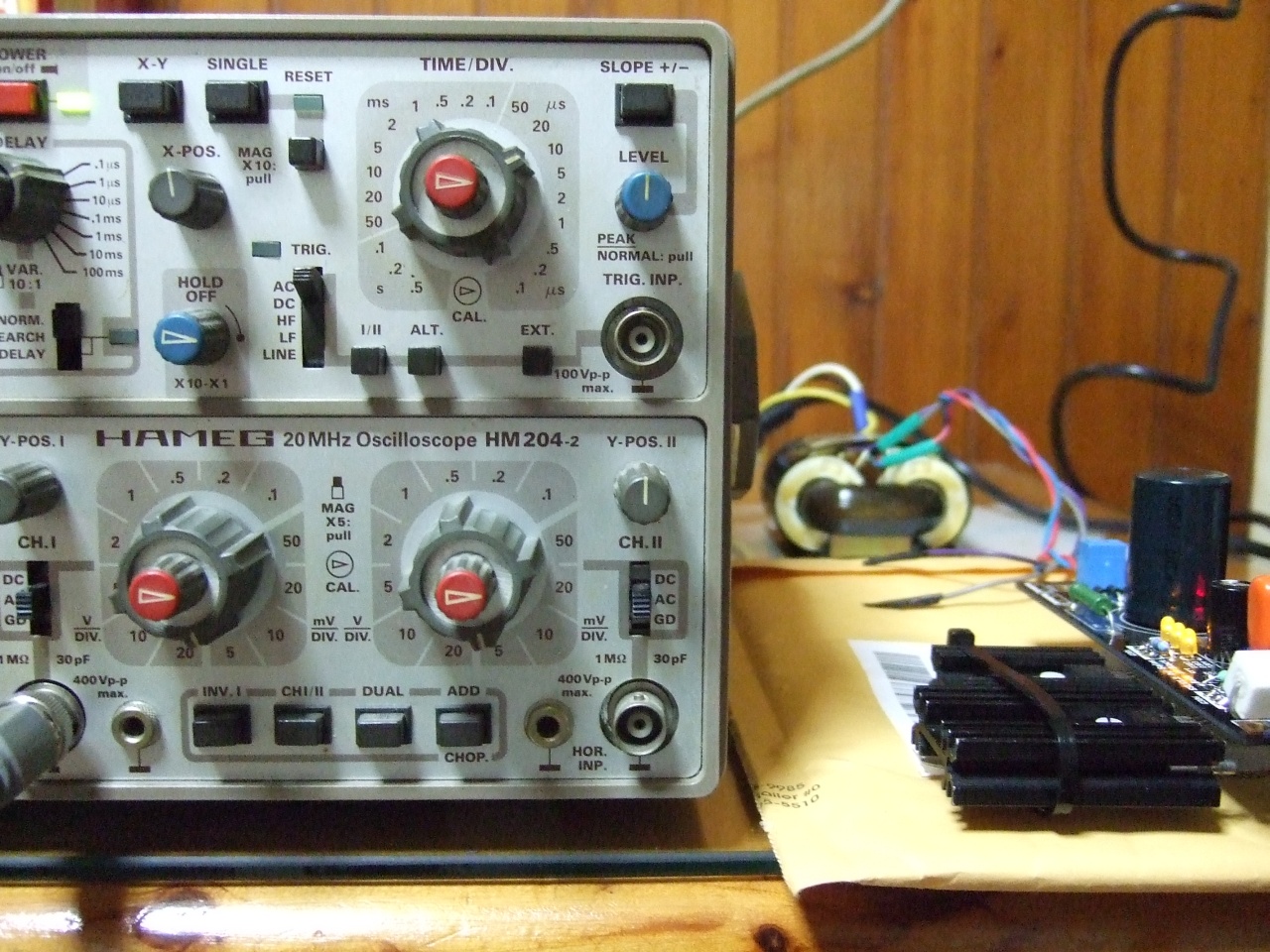

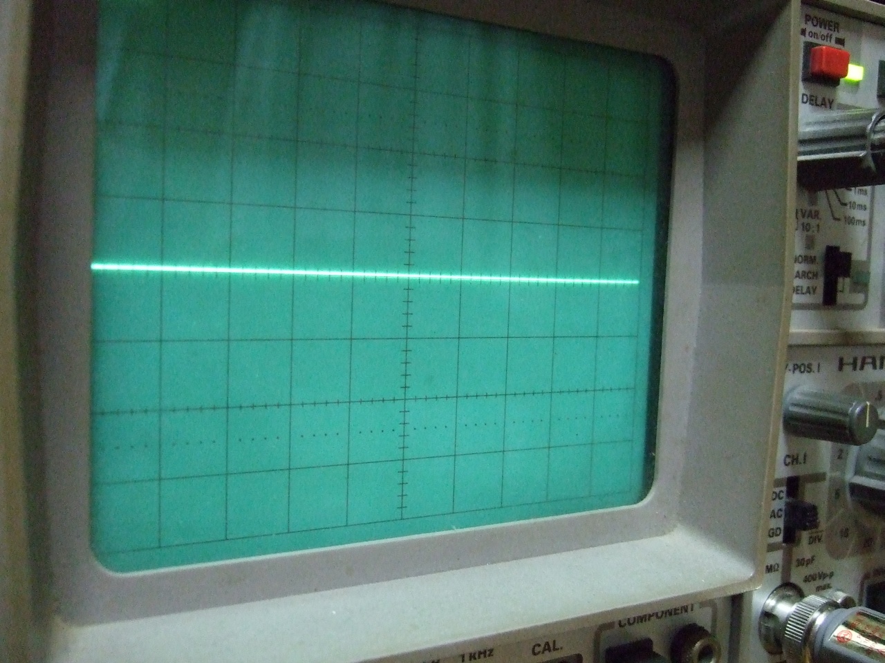

Hi, was playing with the scope just now trying to track noise once more. To no avail with my scope. Its best is 5mV/diV. So I set it there and to 10us. From GD to AC it just seems brighter, not thicker when the reg is on, and the rascal gets a wee bit thicker only if I power the reg off. And that is with smallest 4u7 on output. I asked my bro for visual opinion, he took the mickey, so I quit.😀
Naah, its not a good scope. Maybe I can estimate 0.08mV of noise for 100kHZ bandwidth with my hawk eye 😀 despite my bro laughing at me.😛
No! I pulled the X5 and used the magnifier now... 0.024mV. OK, useless, he was right to laugh. Now I really quit.🙂
Come to where I work, I can get you permission to use the labs equipment :- )
You will find amazing scopes, analyzers, etc..
Amazing places there. Maybe I could check on equipment noise well after the street noise will have been settled.😉

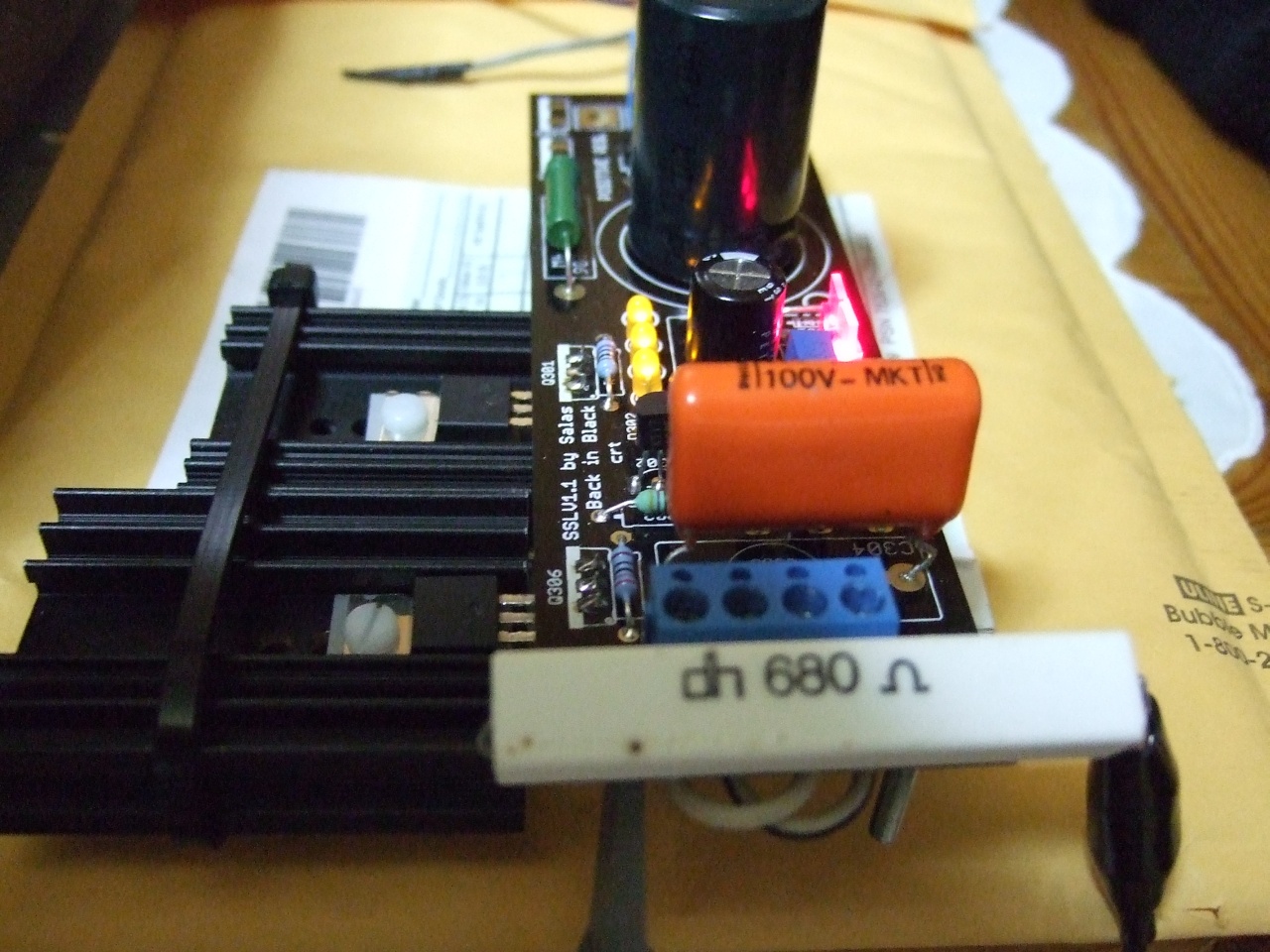

this Is better than DCB1 used as a regulator ?
what are main key features between two pcbs

This is a general regulator, easily configurable, has different open loop gain and damping characteristics. Faster. The DCB1 on board regulator is mainly ''voiced'' and configured for DCB1. Has no remote sensing or features for easy different voltage targets and uses TO-247s.
