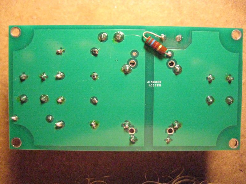

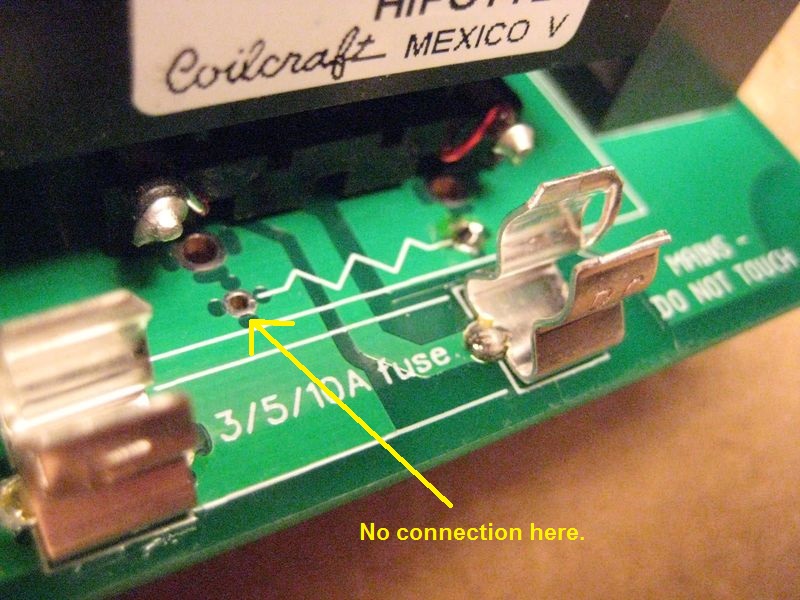

Until then just move the resistor or replace it if you are worried. There is no reason to replace GB #2-3 boards with something else when they work as intended, and can be made so the resistor wont be the secondary fuse for free or a few cents.

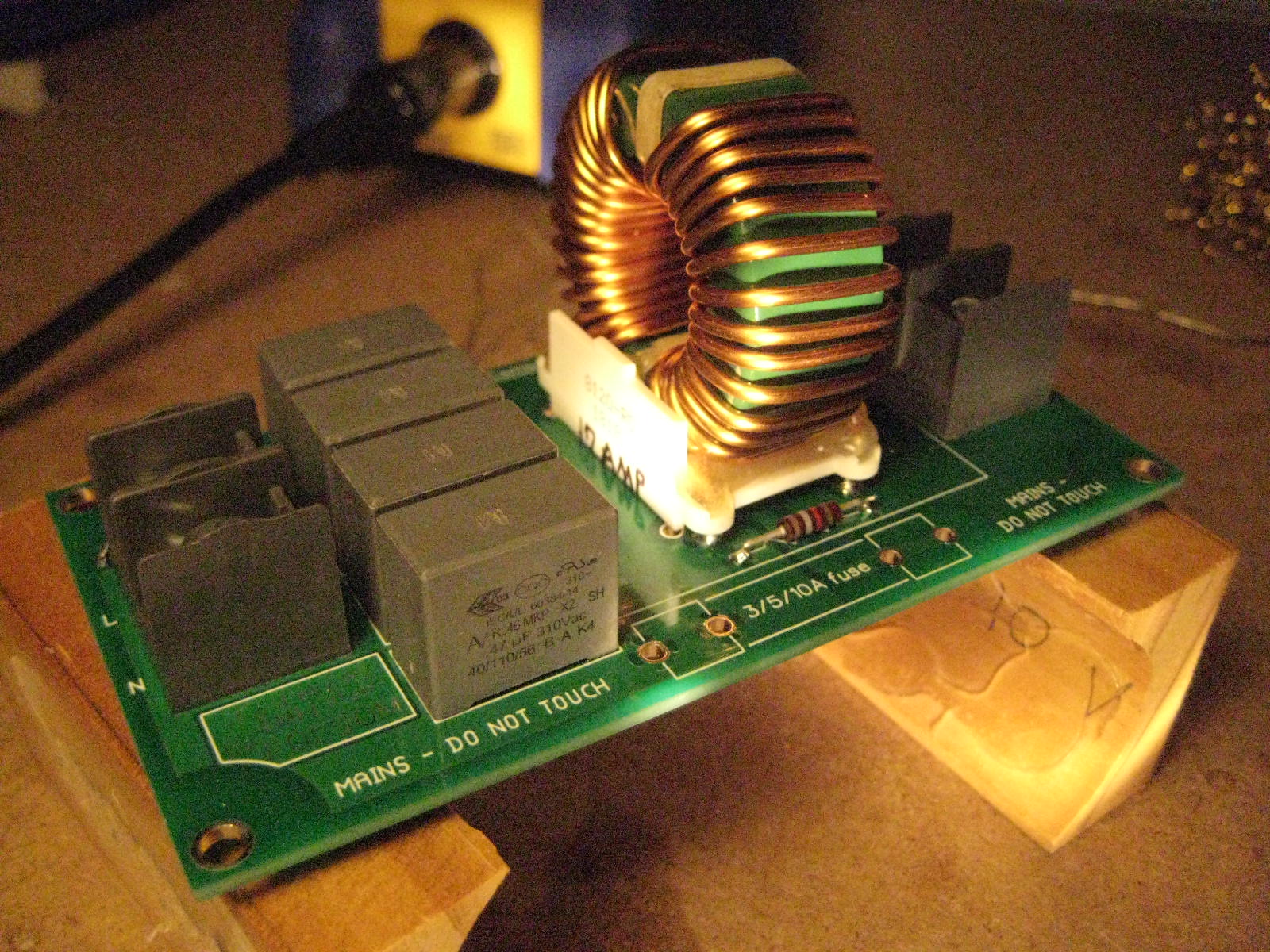

Hmmm I have these filters... Together with one of the DC traps from another group buy... And I have a small humming... Is it possible that these filters cause that? Or is it the DC trap before the filter?
I would try without the DC trap. Once before on a rather different power filter it did not like a DC trap. The result was heat, however. But there is enough similarity between the two that I would give a shot without the DC trap first.

Did try it without DC trap..
Nothing changed...
I have three of these filters which are fed parallel everyone has its own power outlet...

Where is the hum coming from exactly?

The hum is coming from inside of the cabinet where the filters are placed...

There are a few boards left (from GB #3). If you specify quantity I can PM you, otherwise PM me.
As long as none of them are cold soldered then it's no big deal. You should be able to see solder flow onto the pad of the via. One you have that, it should all be good even if you have a little extra solder. Obviously you shouldn't be able to wiggle anything freely.

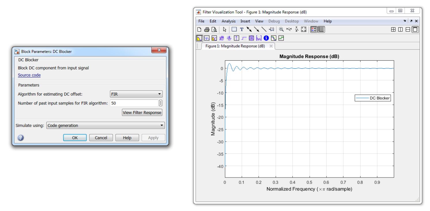

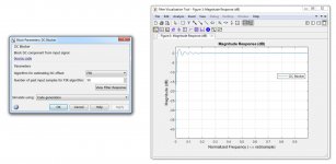

FWIW, I ran across this info on DC-Blocking and thought it was interesting al-tho over my head. Problem is you have to buy the software. They do have other software that looks interesting. Just thought I'd pass it along for anyone interested.
Block DC component - Simulink
