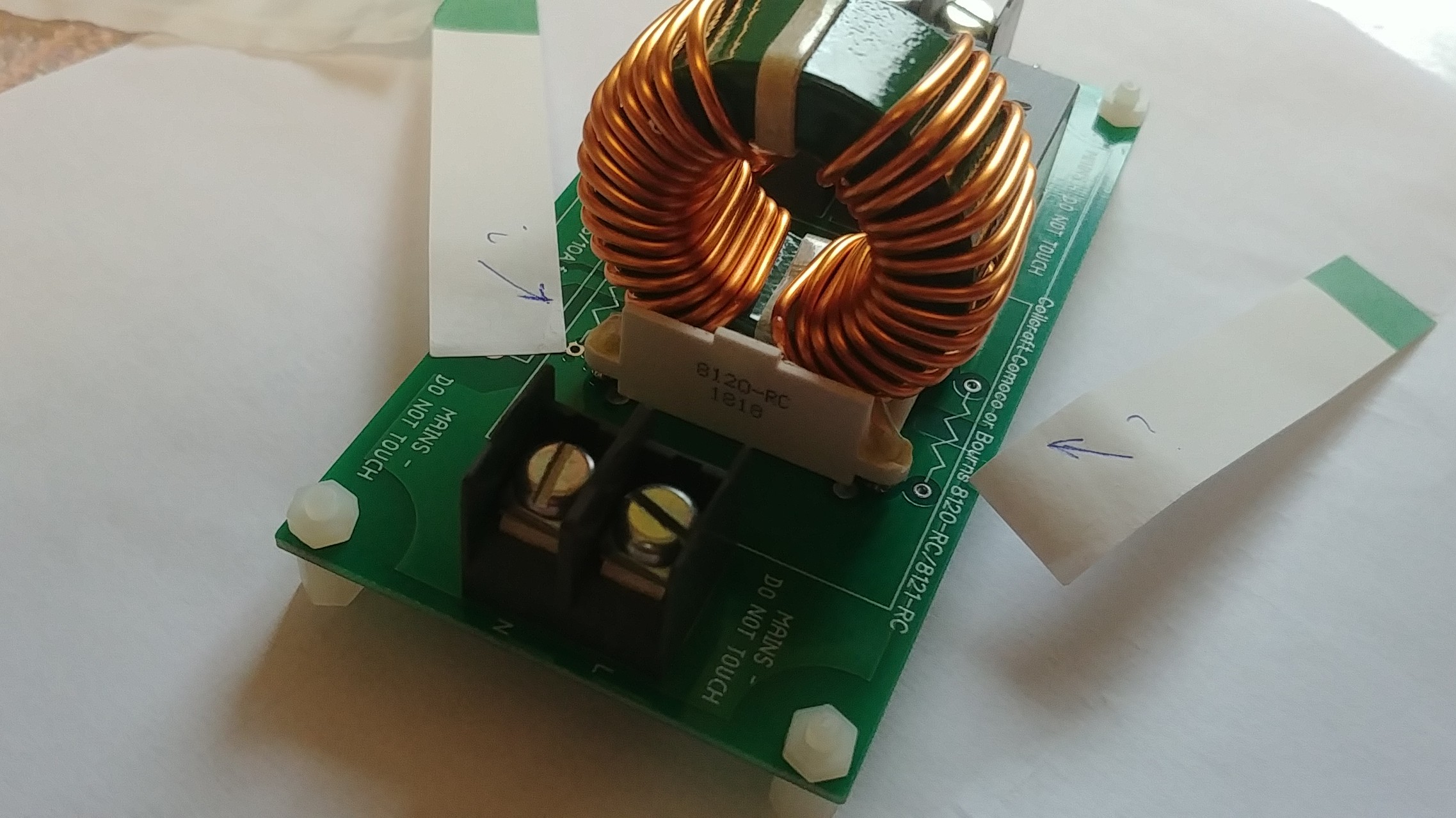

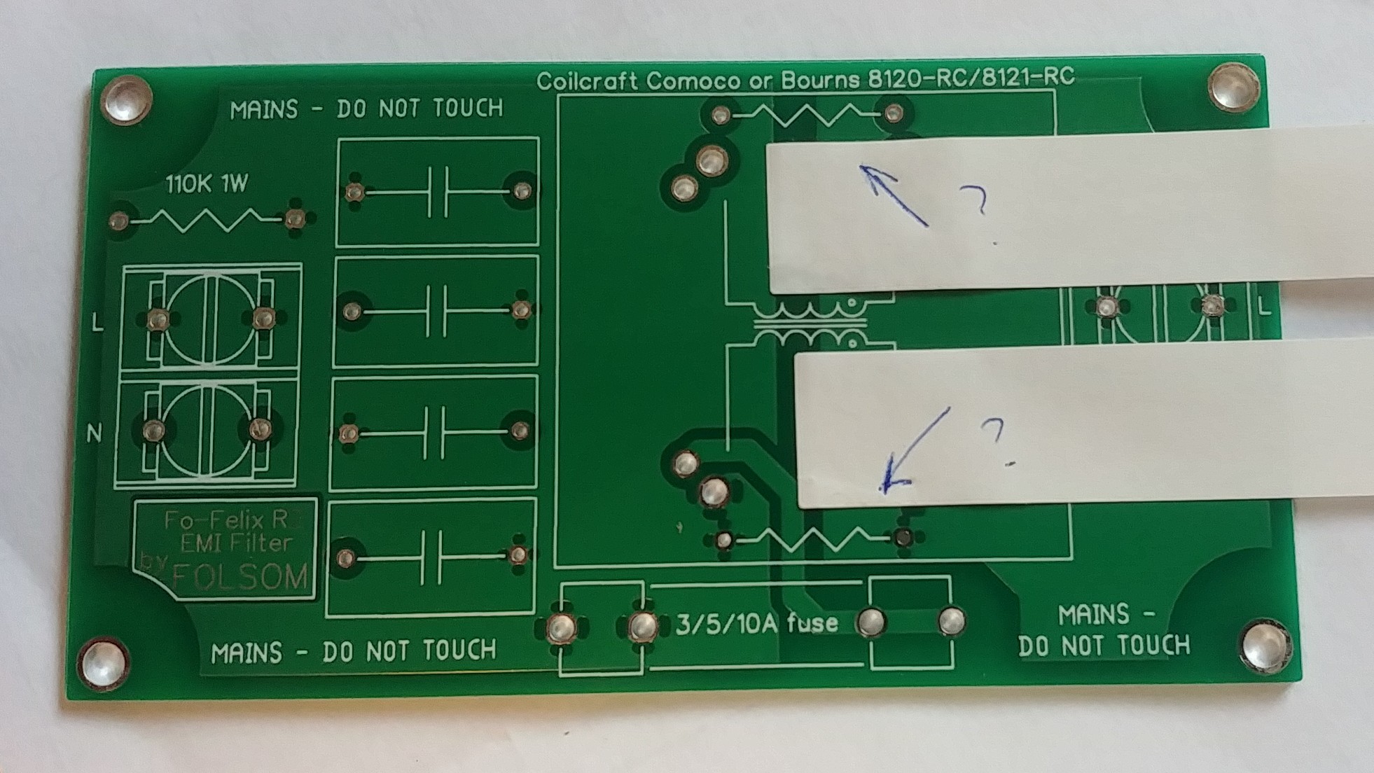

Do we need one or three resistors per pcb? All 110K 1W?
Grateful if anyone can clarify. Thanks!
Thanks for your response Ed.
In addition to the resistor right next to the main terminals, there are holes on both sides of the coil for another two resistors (see photos below). Looking at the photos at Post #1, it appears that resistors need to be installed there. However, the BOM at Post #1 does not state the value and power rating for those two resistors. That's why I am confused.
Those are bypass resistors which needs to be matched against the chokes which you select. Your photo shows the Bourns so you need to pick the right carbon composite resistors against their ratings. Destroyer OS will be able to advise the values for them.
