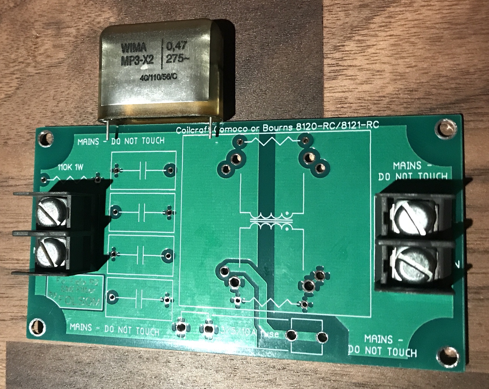

Thanks. So the pcb layout is different for the holes in the Bourns vs Coilcraft !?
Correct
I would prefer you use X2 rated caps because they are made to fail in a specific way. I won't recommend anything else. But I can tell you Audience has used audio caps in theirs.
.47uf Wima MP3-X2 do not fit.
Can you recommend some alternative X2 caps and let us know the max form factor?
Also can you provide the same for fuse holder and fuse to avoid sourcing parts which may not be a good fit?

Did you not get the email? PM me your email.
Fuses are as standard as possible. Mouser has over 12k fuse holders & Digikey 10k.
The capacitors are 15mm lead spacing, 10mm width tops.
Mouser caps
Digikey
In what way do the MP3-X2 caps not fit? It looks like many of them have 15mm lead spacing.
Mouser caps
Digikey

What is the part number on those wimas?
MPX21W3470FK00MYSD
https://www.mouser.com/ds/2/440/e_WIMA_MP_3-X2-1139937.pdf
That exact model number has lead spacing of 27.5mm, not 15mm. That's why it won't fit.

Yes my fault I didn’t think look closely.
