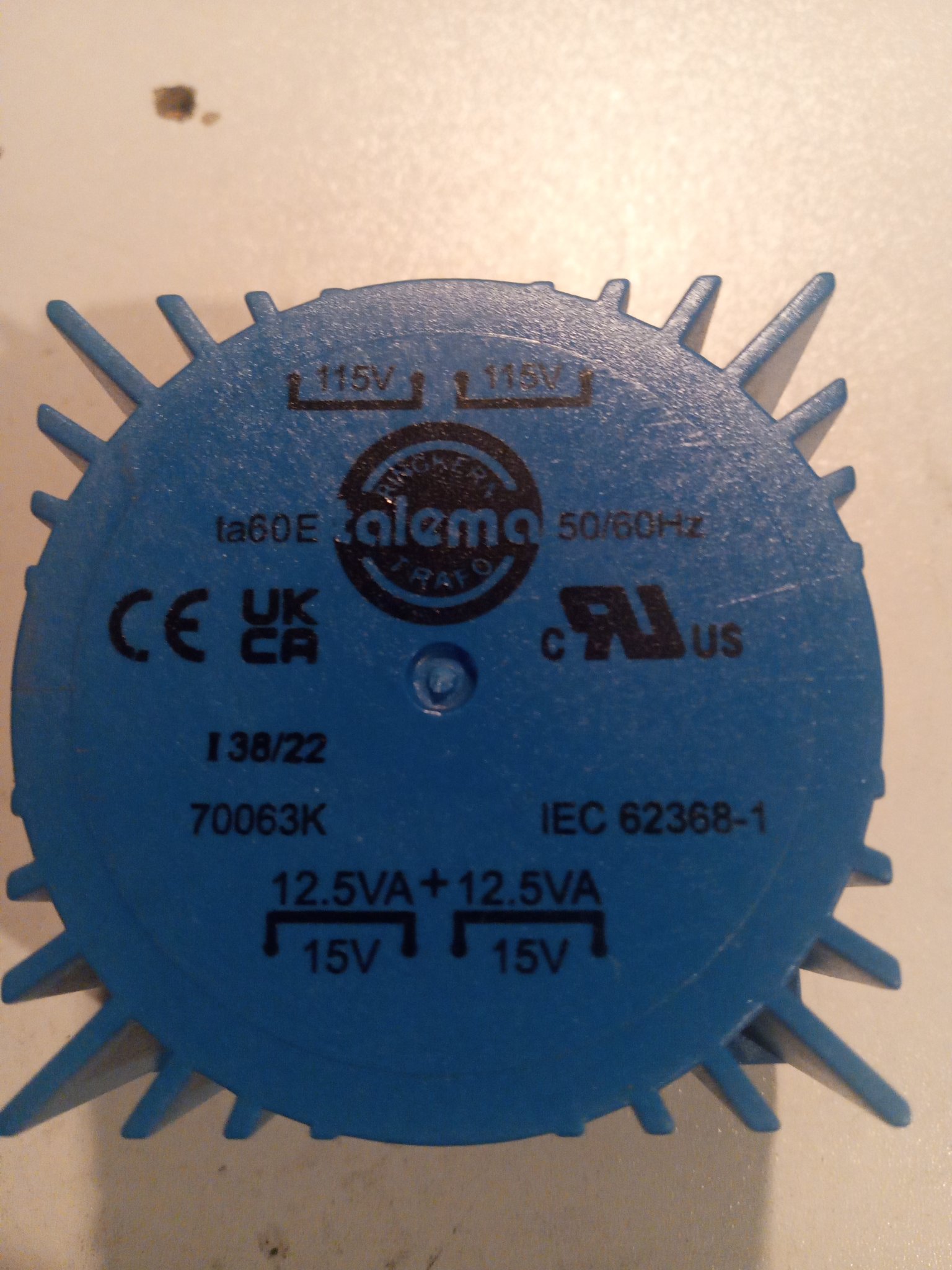

A quick question I have a couple of the Talema 70063 transformer's left from a previous GB.
The height of them is approx 38mm and as I understand, a 1U (rack unit) height is 44mm. They should fit the 1U enclosure being advertised by Gianluca, Correct!. Unless 1U is a different measurement in this case. See the pic attached of the trans...

The 25VA version will be too tall. I think the 1U is 40mm inside. 37.5mm height Transformer + PCB + standoffs = too tall.
Wow, I can't believe that pic in post #242 ended up so dark. Yeah, it would be to tall for the 1U case. Need to ponder a bit to decide the best way forward. Thanks
