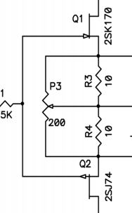

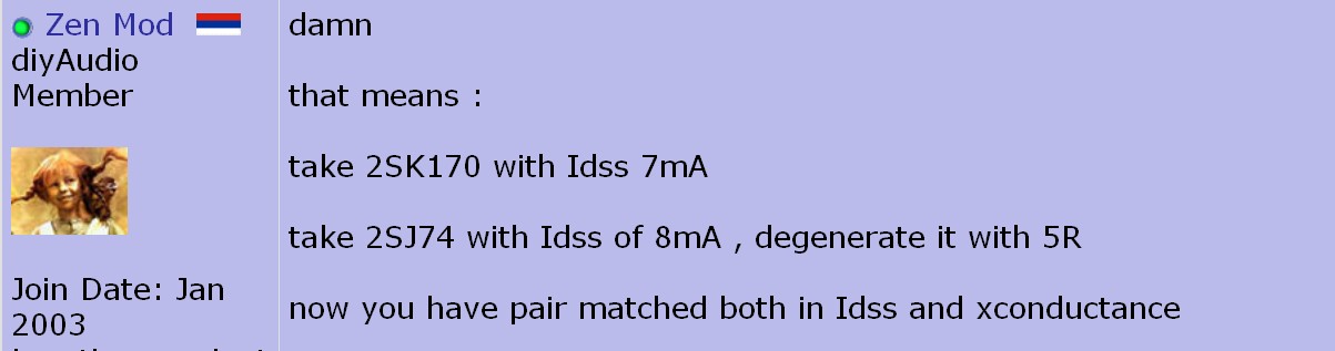

HI I will like have the psu compatibility M2 and Vfet V2 ... a good custom iron with 18v and 22v tap in EU ??
the jfet idss ?
thanks
the jfet idss ?
thanks
HI Tea-Bag thanks ,will be better as in ZM post that means R4 to 5R or better put a trim pot P3 like ?JFET IDSS would be good ~8ma for each option.
