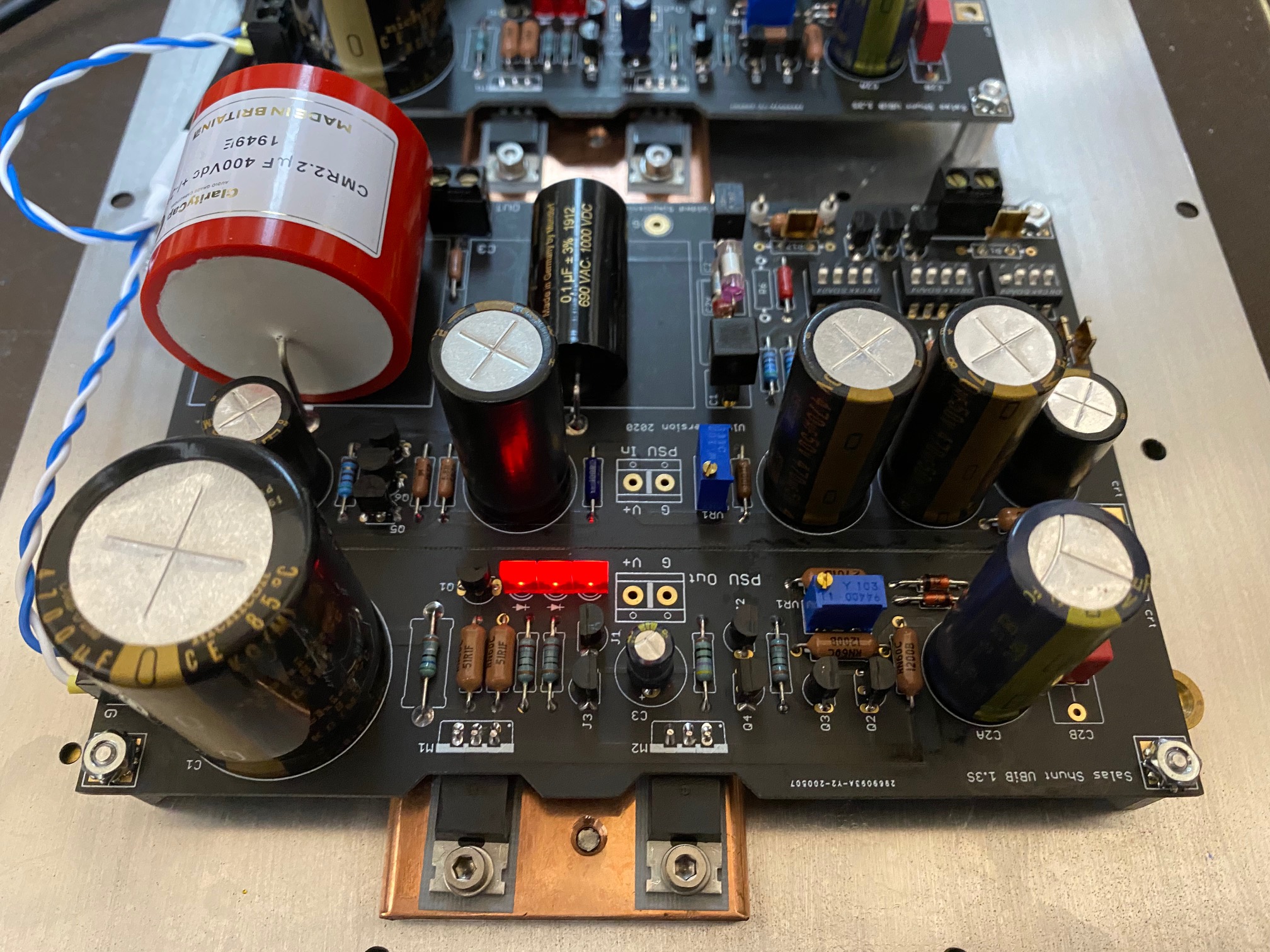

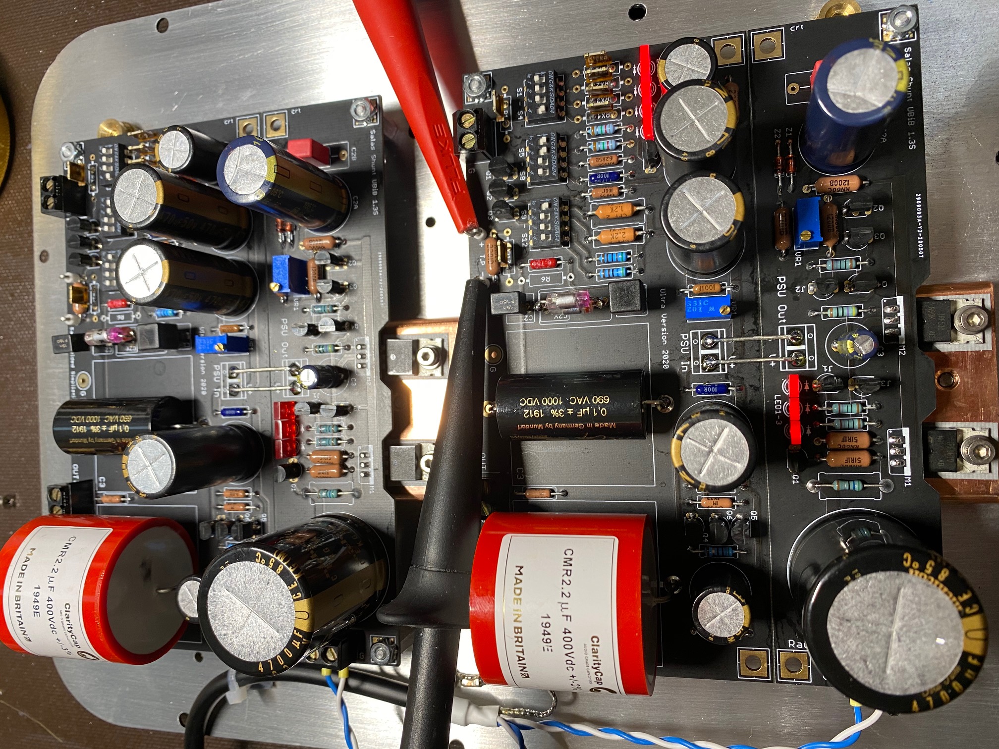

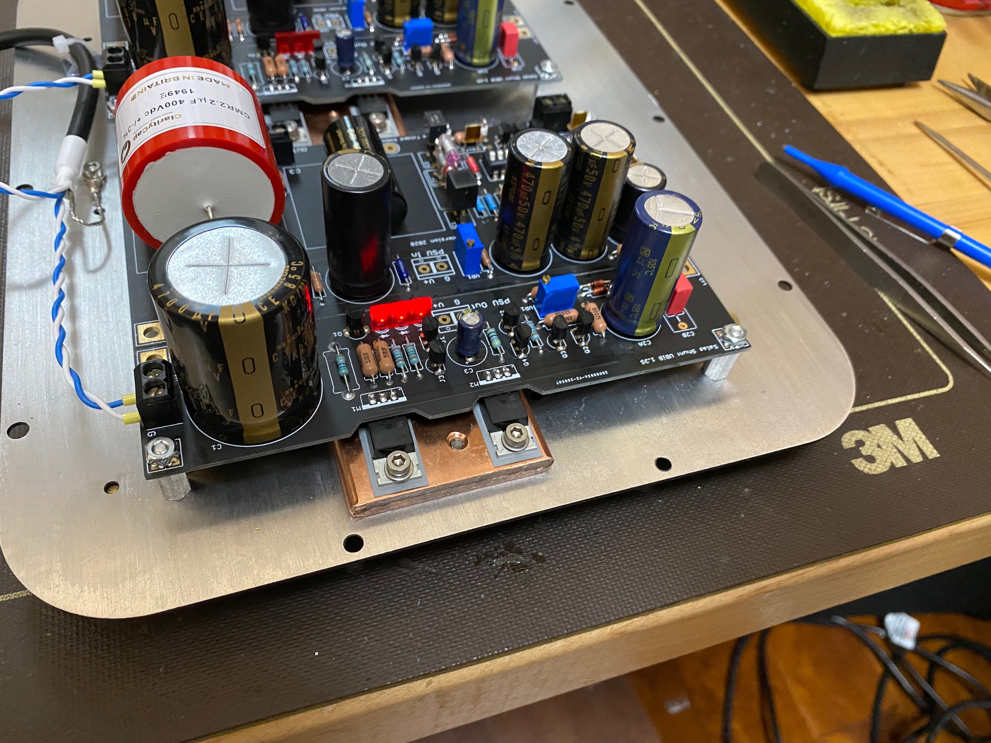

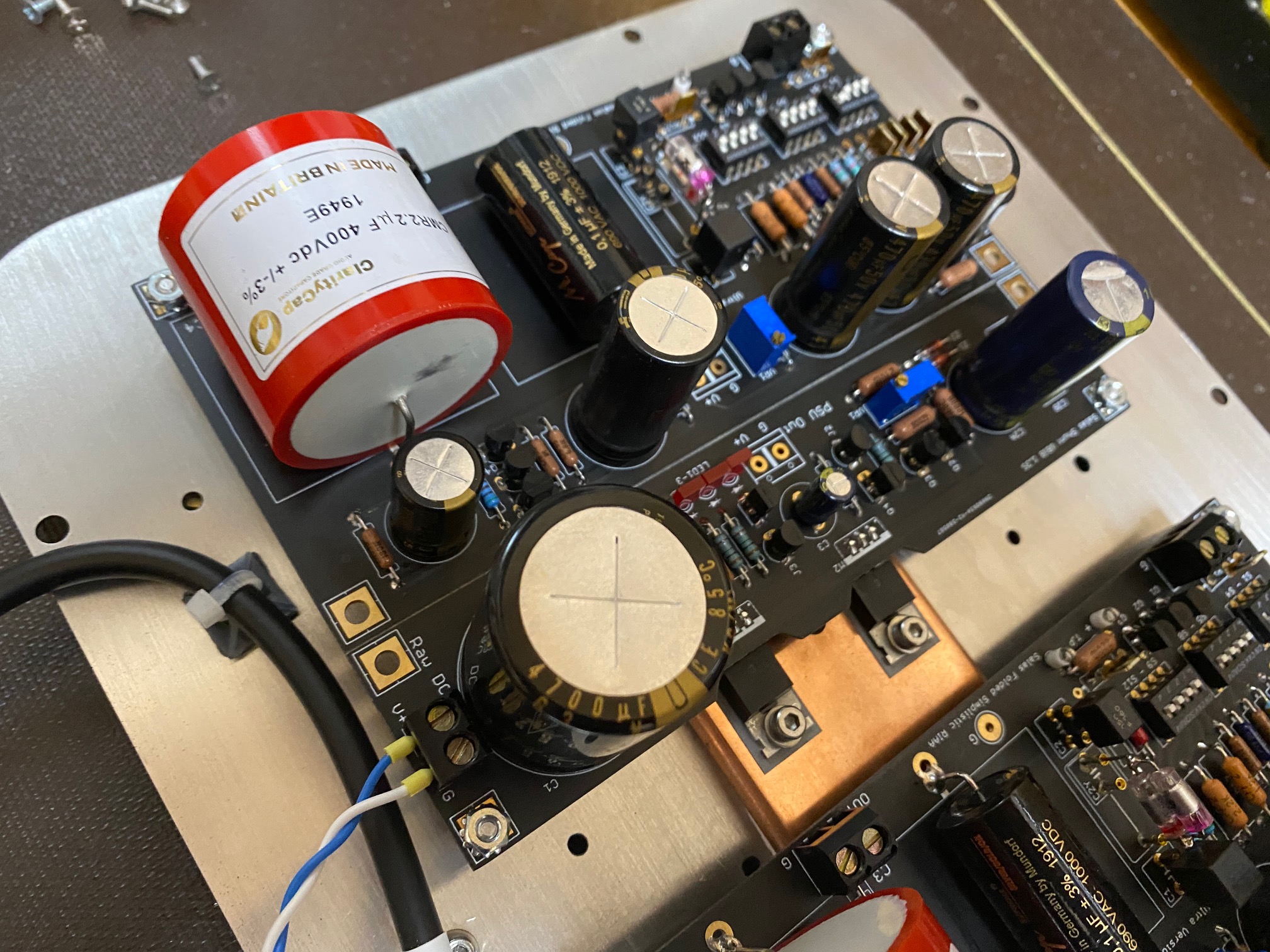

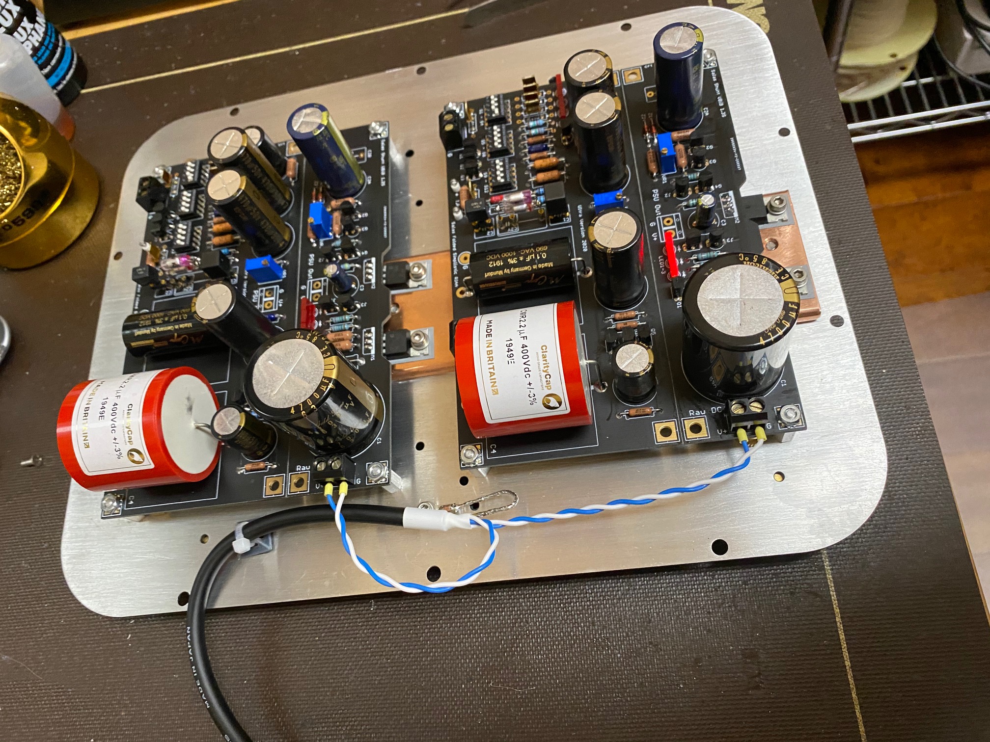

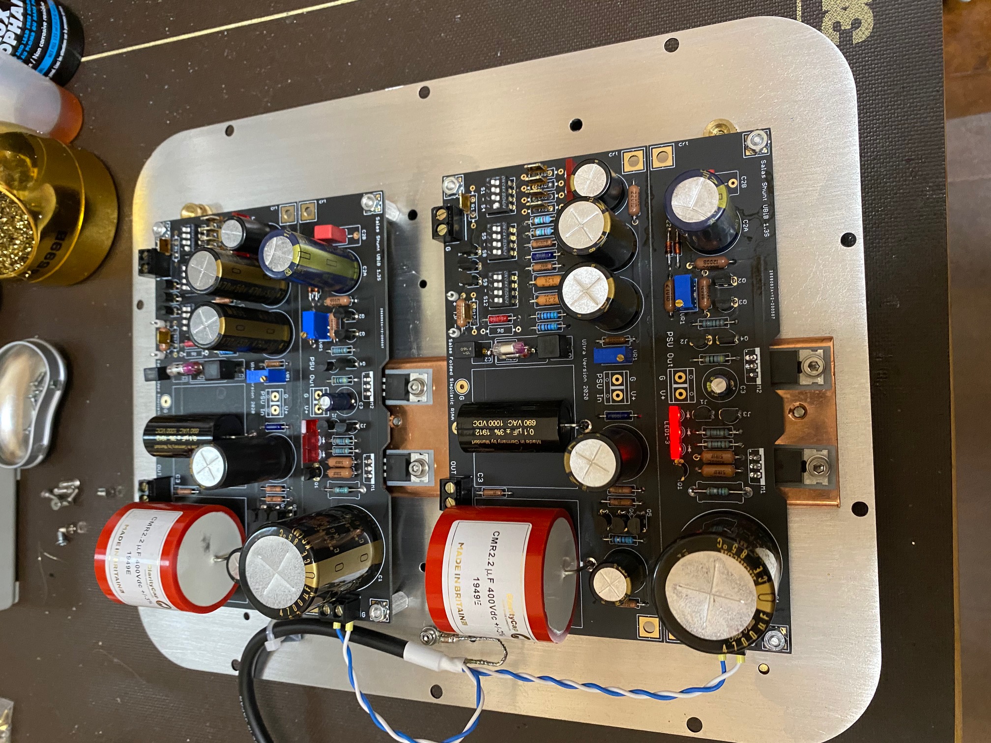

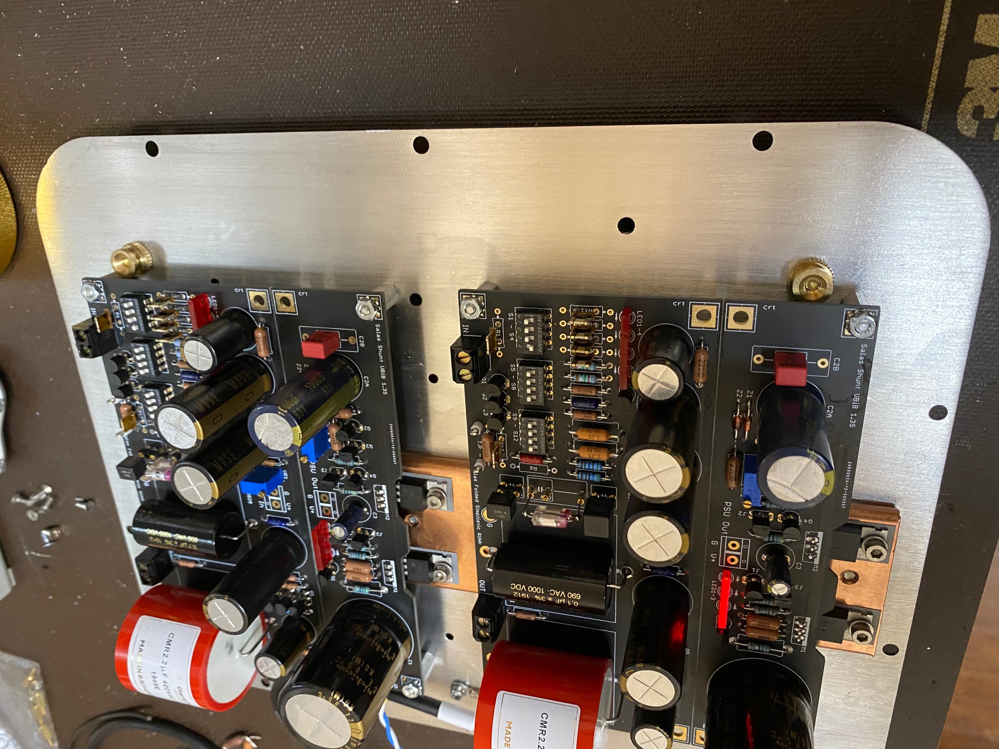

Here is my Beta test report for assembly, first power up and initial setup:
• Nothing special about Raw DC part. Just need to keep output voltage under load in ballpark, as Salas indicated on first page. I used my Electronic Load for 100mA(Thanks to Salas for reminder. I already almost forgot that I have one. It was broken and I repaired it due to that project necessity). I found needed Rd for Raw DC to output 46VDC. You can use power resistor to simulate same load instead.

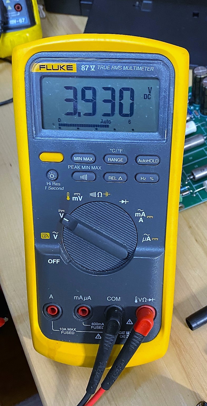

• About Phono… I got all semi, small capacitors and some precision resistors from Tea-Bag (same as kit). All the rest of parts I had in my bin, beside 0.1uF and 2.2uF caps which I acquired within <1% matching from Partsconnexion. Assembly is easy and requires some basic soldering skills. It is very much same level of intricacy as you probably see on all devices designed by Salas. Very low possibility for making mistakes. When all parts are in hands and all matched part are sorted out, the full assembly and final cleaning should take about 2 hours. As you see on my images, I used copper plate for semis. I just made some overkill (since I could use my bottom plate alone), but I decided to be prepared for future 150mA CC setup and test (if I'll decide to try). BTW, I did not connect UntraBIB to Phono yet till I powered UltraBIB first and set its Trimmer for Vout close to 34VCD. Then, I soldered links from UltraBIB power Out to Phono power IN. Powered up all gain and now all (include Phono side) LEDs are lighted up. At that point, I adjusted UBIB again for 34VDC. I noticed that three UBIB LEDs are bit more dim in brightness compare to Phono LEDs. It might scare some of you…. TP voltage was 0 at that point, but turning trimmer clockwise brought me to the needed 4VDC BIOS.
• So, this is it by now and I’ll box it during this weekend. Listening session will be done soon and I’ll report accordingly.

Power section's LEDS run well below 5mA on J1's degenerated IDSS, phono section's LEDS mA (and brightness) depending on Q7's free IDSS. J1 must not use high bias because it's exposed to higher voltage than the other JFETs. To avoid life shortening dissipation levels.

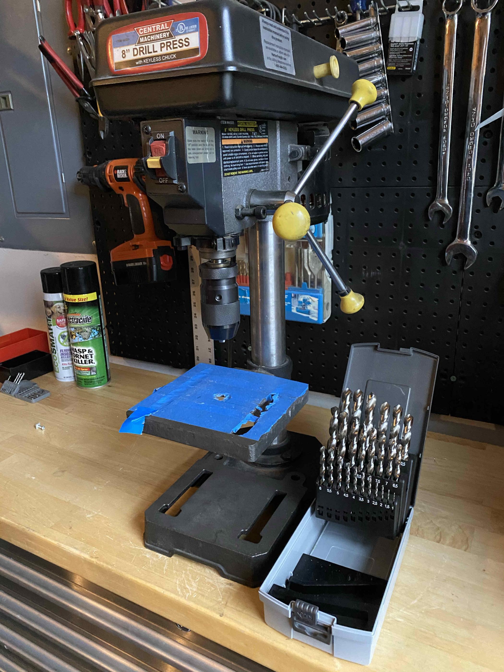

Hi Don, thank you for complement. I’m not that fast.. . It took me about 12 days to get all needed elements to assemble it till I would be able to test it electrically. I use my eyes... , and nothing else special. I have cheap Chinese table top drill press ($65) from Harbor Freight.
However, I use CNC shope for my front panels. All other location
holes are made by me. I’m lucky since I had my bachelor in mechanical engineering once .
