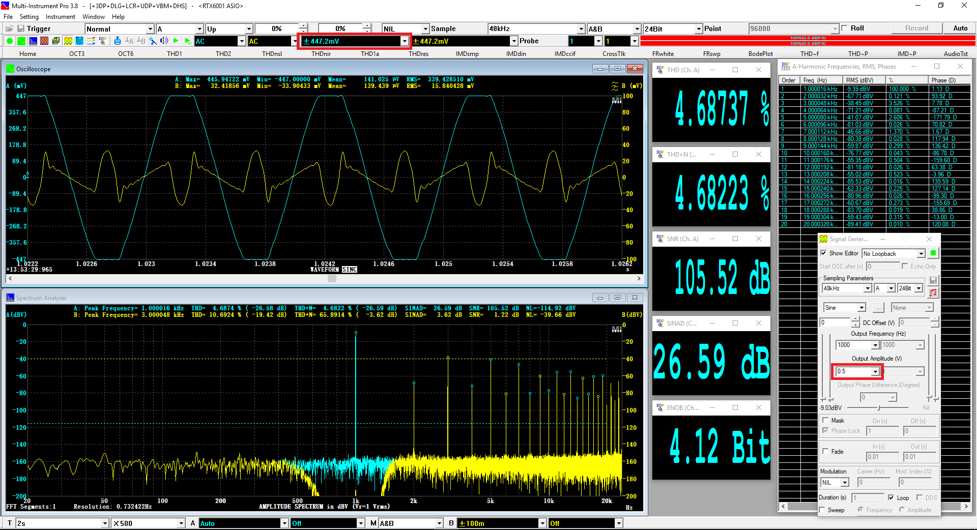

Real-Time Waveform Comparison between a Sinewave and Its Harmonic & Noise Residue
It is now possible to use MI to perform conveniently a waveform comparison between a sine wave and its harmonic and noise residue without any external means (e.g. a hardware notch filter to remove the fundamental). A sample panel setting can be found with the button “THDres” in the Hot Panel Setting Toolbar. If clicked, it will load a pre-configured Panel Setting File which contains basically the following two important settings:
(1) [Setting]>[ADC Device]>”Channel Operation”>”A=iA, B=iA”. It duplicates the signal from the physical input Channel A (“iA”) to both the logical input channels “A” and “B”.
(2) [Oscilloscope Processing]>”Digital Filtering”>” 500Hz ~ 1500Hz band-stop 1022nd -order Kaiser Windowed FIR filter” with FIR delay removed. This software filter is applied to the logical input channel “B” only, so that one can compare the original sinewave (in Ch.A) with its duplicate that has the fundamental removed (in Ch. B).
DDP Array Viewer is used here to show the harmonic frequencies, amplitudes, and phases. The phase information will only be available if [FFT Size]<=[Record Length]< 2×[FFT Size] and no inter-frame average is used.
The setting provides roughly 120 dB attenuation at 1kHz. If you change the sampling rate, you may need to change the order of FIR accordingly to keep this attenuation ratio.
The attached screenshot is an example showing a slightly clipped sinewave and its harmonic and noise residue. Please note that, if the residue is very small (which is usually the case), you can right click the oscilloscope and select “AutoScaling” to make it suitable for viewing. Unfortunately this has to be done manually as it is not possible to preset a correct Y Scale for Ch. B in advance.
One application of this type of comparison is to show the phase relationship graphically between harmonics and fundamental, which is more intuitive than the phase information displayed in numbers in the DDP Array Viewer. One such application example can be found at:

One advantage of using FIR filters and FFT filters in this type of application is that they provide linear phase or “zero” phase response if FIR delay is removed. Thus perfect time alignment can be achieved between the original and the filtered one. This is difficult for analog filters. The disadvantage is that the dynamic range is affected. But RTX6001 should be good enough in this type of application for most of the cases.

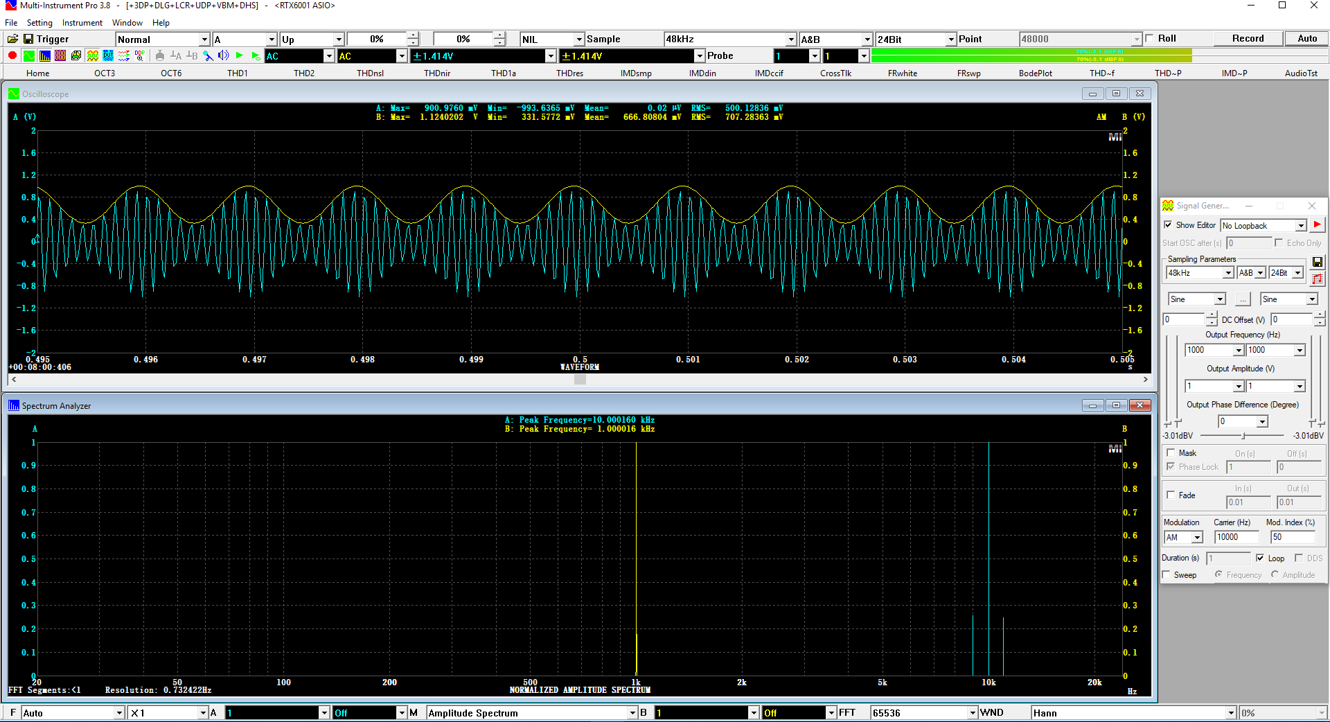

Modulation and Demodulation
The software manual can be brought up by pressing F1, or go to [help=>[Software Manual]. The hardware manual can be accessed through [help=>[Hardware Manual].
AM, FM, PM modulation is supported by the Signal Generator.
AM, FM, PM demodulation is supported by the Oscilloscope.
I attach a Panel Setting File here to demonstrate the AM modulation and demodulation. The loopback test result is shown in the attached screenshot. The signal generator generates an AM signal. In the oscilloscope, Ch. A shows the AM signal while Ch. B shows the demodulated signal.]%[/help]]%[/help]

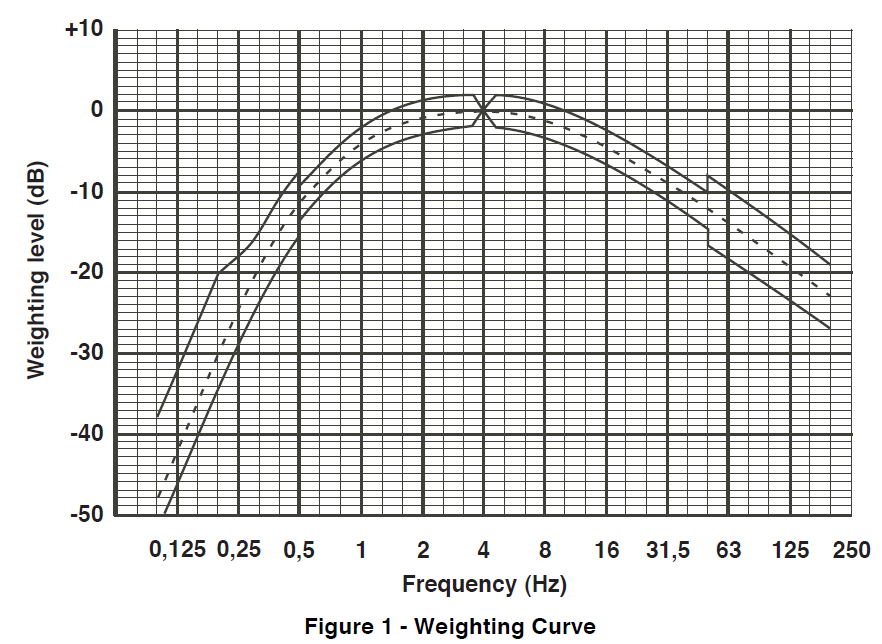

Wow & Flutter Measurement
Thanks, that website is a very good reference for Wow & Flutter Measurement.
MI Full Package supports W&F measurement according to AES6-2008 (r2012). It is compatible with IEC 60386 Ed.1 1972, IEEE Std-193, CCIR 409-2, and DIN 45507. For W&F measurement, the record length (sampling duration) must be greater than 5s in order to capture sufficiently low modulating frequency (called Drift and Wow). Both psychoacoustically weighted and non-weighted peak W& F measurements are supported.
Attached are the weighting curve and a W&F measurement example. In the example, Ch. A shows a 3150Hz carrier frequency modulated by a 4Hz sinewave with a max. frequency deviation of 3.15Hz. Ch. B shows the FM demodulated signal (It is not required for W&F measurements, but it is shown here for demo purpose). Theoretical peak W&F value in this example can be calculated as 3.15Hz / 3150Hz × sin(0.95×90°) = 0.0997%. The test result matches this very well as shown. The testing signal can be generated using the Signal Generator of MI as shown in the screenshot. It can also be downloaded from: www.virtins.com/3150HzModulatedBy4HzAt0.0997Percent3.15Hz.wav
