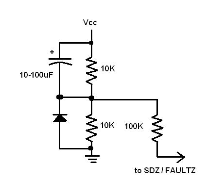

When you mute with mute pin and power off, there is pop. Powerconsumption is about same as normal too. Output mosfets operate same as in idle/ no signal, there is output.
Mute with sdz pin and mosfets are switched off, no output produced, powerconsumption reduced, no pop when power is removed.

Hmm, interesting. TI datasheet suggested the outputs are off with the Mute pin pulled high, I am not sure if they literally implied a shutdown of the output mosfets then.
Are you currently using the SDZ pin then ?
well may be simpler, power off and mute goes low and pop will be heard because there is no mute, use sdz first to mute, pull it low, removing power keeps it low and pop has no chance LOL
ampboards without any pop I have use sdz first, used to be in datasheet, don't know what changed there if it changed. pop not really problem with other boards for me, except sure3116 maybe.
The TPA's outputs don't switch with MUTE held high. Holding MUTE high during power-off will prevent a turn-off pop.
To prevent a turn-on pop you want to raise SDZ, wait a period of time for the input coupling caps to charge, then lower MUTE to enable the output.

The DUG board does have this C1 capacitor, both legs of which are tied to 100k resistors which then goes to v+ and gnd that charges up to pull both SDZ high and Mute low at turn on. There is no turn-on pop whatsoever.
I am going to tinker with the boards for the turn-off part (for curiosity really, not bothered by the weak pop), thanks for chiming in Gary!

I was thinking of a circuit something like this...on my list of things to try.

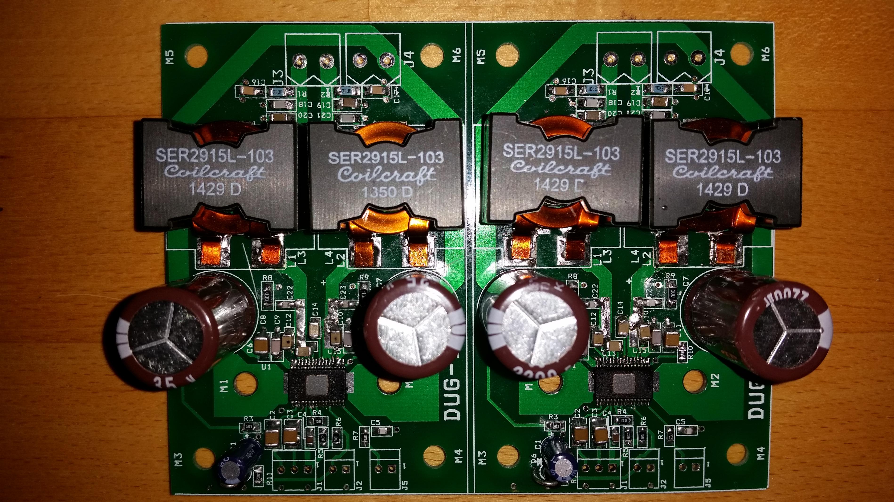

Finally my Mouser parts arrived and this is my overnight work.
20150924_231019_zpsdfq1ckqx.jpg Photo by snake69fast | Photobucket
Looking in the forum pages how to wire this I realized that I don't need the C5/R7 (and I didn't understand for what are them... 🙂 ).
I saw balanced input and the normal one. Which one is recommended? I don't want to do something wrong now at the end of this adventure and ruin my work.

You won't ruin work 🙂 That is with psu connected where it is supposed to go🙂
For input you can short middle J1 negative input to rightside J1 GND when source is single ended, just a little noisy if you don't, I guess🙂
If you soldered tpa like that yourself I guess gainboard Marcus is also easy for you, looks good!

Remove the C5's.
The only inputs are the balanced ones using J1.
J2 is for any external control of mute.
J3 is for sync of the two chips...I don't use it and don't seem to notice any interaction between the two IC's.
Measure with an ohmmeter your bootstrap caps...I can't tell if there are any shorts underneath some of them.
Do not power up without a load...speakers or 4R-10R resistor. (J3)
You can power up without an input but the open inputs will pick up noise.
J4 is power.

It works!
Bur... only one channel. On the other one I can hear in my 3-way OB at a very very low level only in the mid and tweeter.

Any advise?

Now is fixed.
It was one Coilcraft inductor with a de-soldered leg. I've already solder better all of them.
So full power now 🙂
Input is connected like iiribeo mentioned before "For input you can short middle J1 negative input to rightside J1 GND". I don't have yet a pre with balanced input/output. My DAC does have this but I need some volume control.
