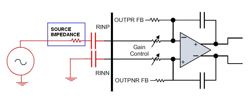

The gain setting I usually use is the 100K/20K combination resulting in 26dB nominally.
I usually provide the 39K resistor as an option FOR 32dB.
G Gain (BTL)____________min nom max
R1 = 100 kΩ, R2 = 20 kΩ__25__26__27
R1 = 100 kΩ, R2 = 39 kΩ__31__32__33
The right half of jpg is the input shown in the data sheet. (page 4)
The left half is an unbalancing of the differential resistor ratios as a result of a source impedance on the (usually) positive input. This can be a pot at mid position or a pre-amp with a high output impedance.
How significant this is I do not know.
I avoid a high impedance source.
As to your question as to whether a tube pre-amp will work the answer is probably yes. Is it the best? IMHO no. 🙂
If you do use a tube pre-amp then I would recommend powering it up then connecting it or power it up with the output shorted until stable DC is established, or put a diode clamping circuit on the signal lines to prevent TPA311x damage. But that is just me. 🙂

DUG,
Thanks for the response. Since I am a schematic challenge and zero knowledge about electronics, the best course for me is to try the tube preamp with my blue yuan-jing TPA 3116 blue board and see what happens. If nothing happen, wouldn't you think it's safe to use in your board?🙂
