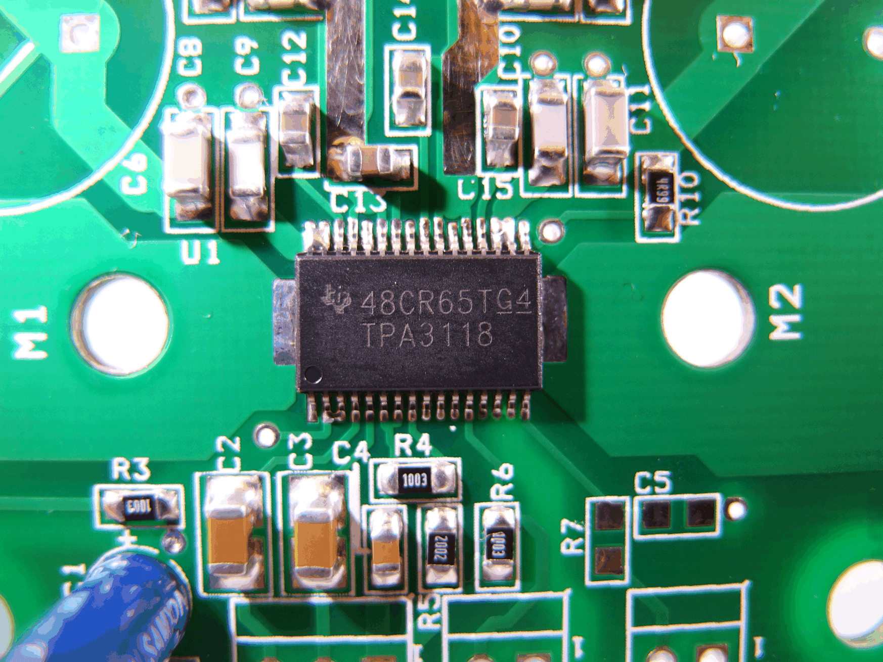

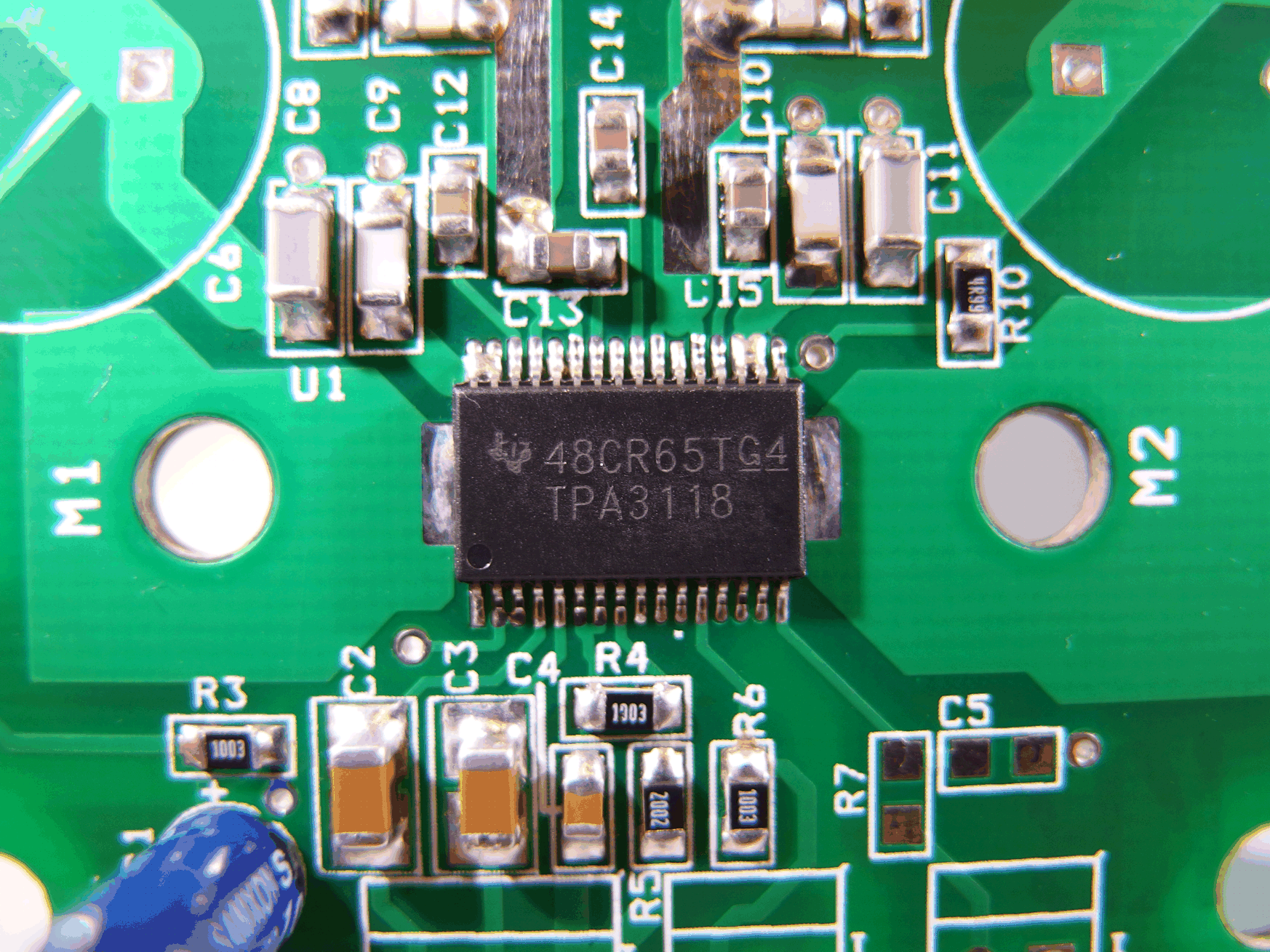

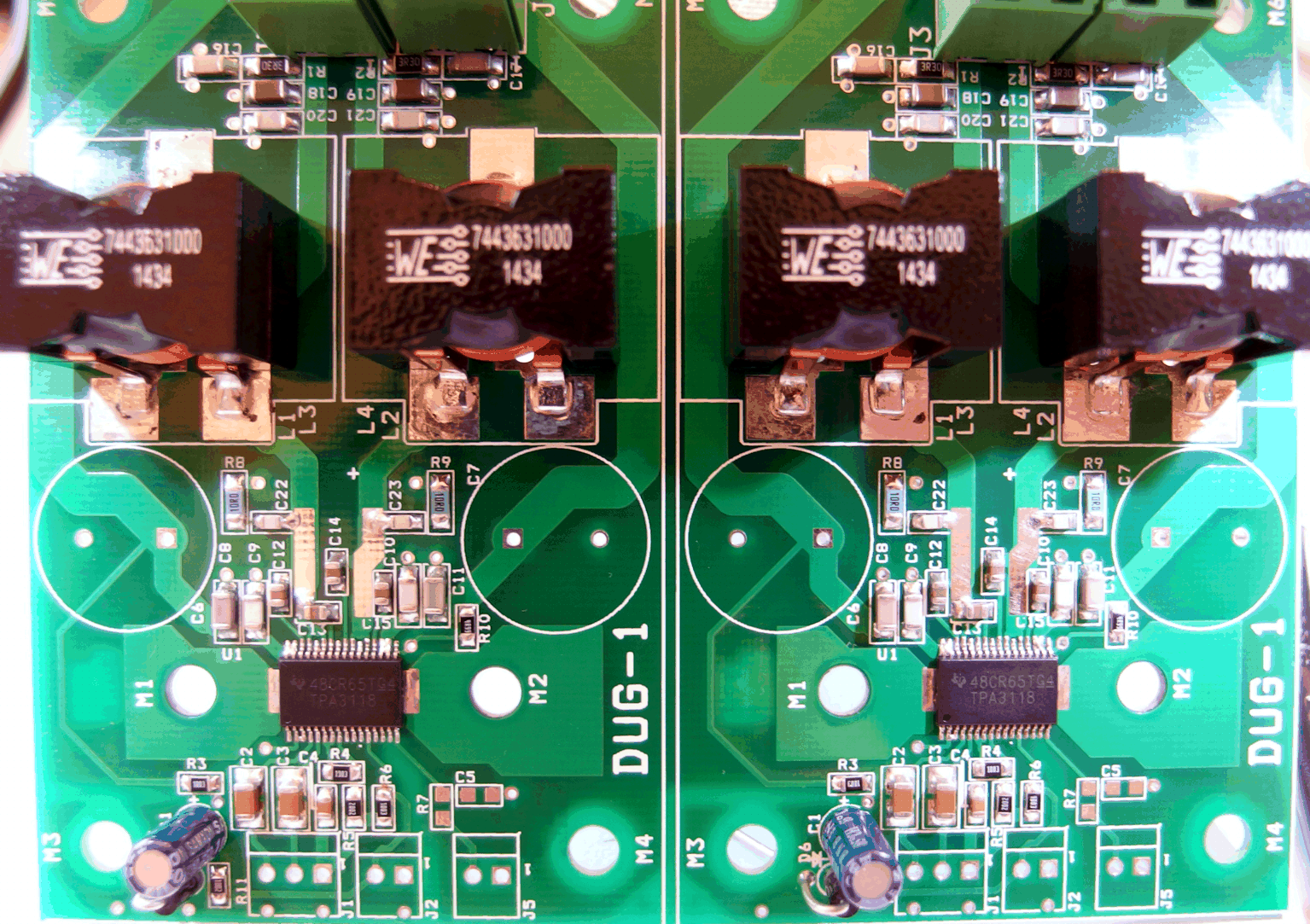

2 boards nearly complete, does everything seem right ?
I just finished soldering most of the 2 dug boards this afternoon. Can anyone with a sharp eye or keen insight take a quick look and suggest if anything is amiss ?
Cheers everyone and thanks in advance to any comments.

Looks very good...especially the IC.
Did you manage to get the bottom pad soldered?

I did solder the bottom pad. I flowed some extra solder onto the exposed pad and then soldered one row of the IC's pins, then pushed down on the IC while heating the pad from the reverse side until the IC lined up flush with the PCB, with lots of flux, of course. This was only the 2nd time I tried to solder these reverse-side power pads, so I hope it is fully soldered.
Thanks DUG! I am going to do a few checks before powering them up later today.

I just powered up my boards after thoroughly checking them. They do not pop on turn on, but do pop at turn off. I will eventually be using the mute switch feature (J2, I think) to mute both boards instead of powering them off via power switches. There will be a master power switch at the back of the amp for power, of course. So I do not think the pop thing will be an issue.
Oh and to DUG:
I just gave the boards a quick listen. So far, they sound good. There is no audible hiss from the speakers that I can detect (with the 2 pairs I tried) and the amplifier ICs stay cool to the touch after a few minutes of loud play (I can not detect warmth from them by touching), so I think the TPA3118s' are soldered properly to the board. Thanks again!
