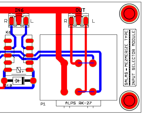

GB For Salas I-Select Mesmerize Type input selector and volume control
When you want to use it as selector only, link the middle pot pads to their respective ones on the right.
