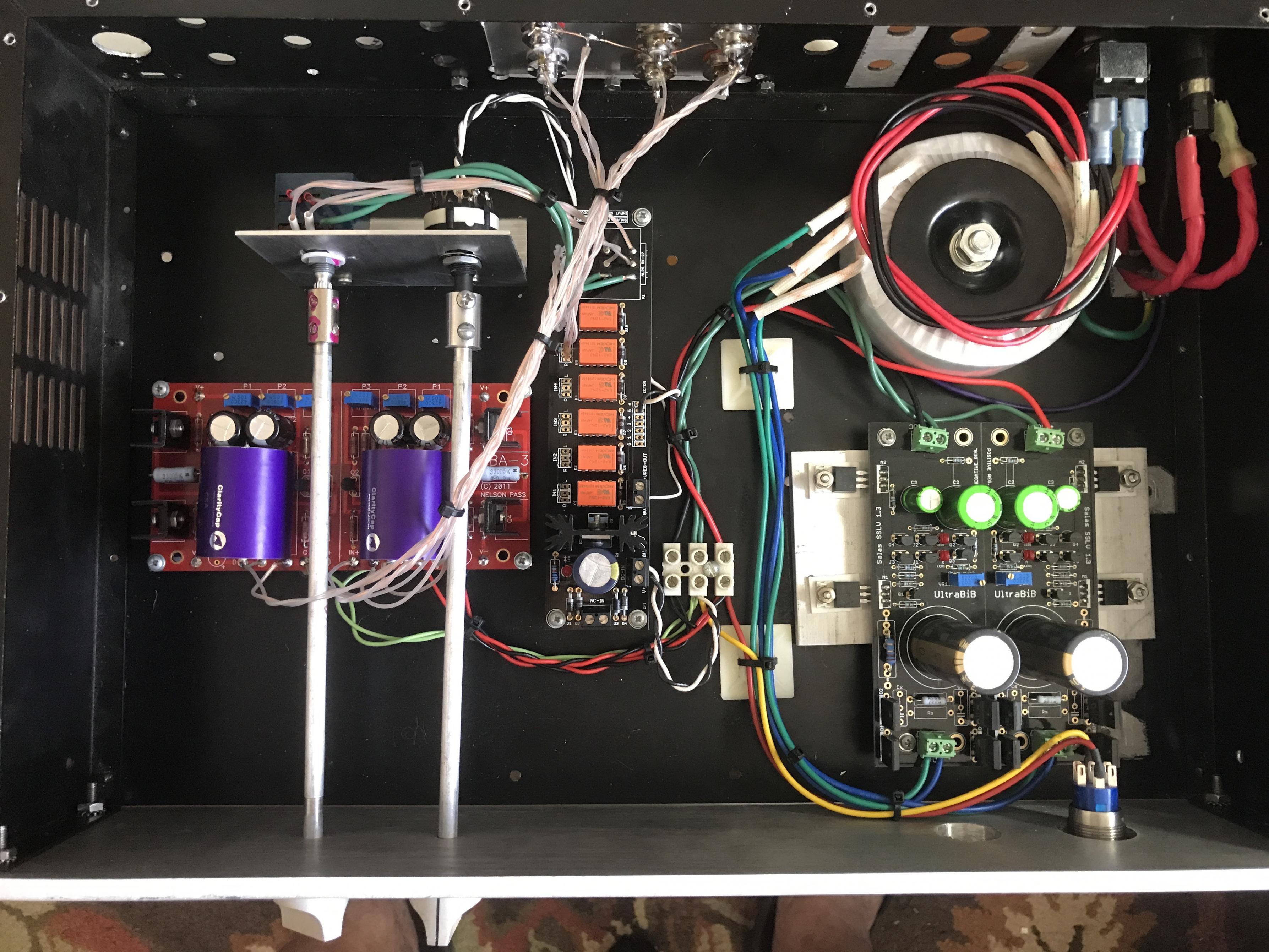

Just installed the I-Select into my BA-3 preamp now I don't have the single going through that creep selector switch. Thanks to Salas and Teabag for making this all possible.

You are welcome. Looking good. By the way, did the UBiB PSU help your sound?
Did it help the sound?
Well it's the only power supply I used in the BA-3 I can't compare one form another. But I can say this my voltages are rock solid as for the sound I was using a Hagerman Clarinet tube preamp which I liked except for the low level hum I was getting that I couldn't figure out where it was coming from. With the BA-3 in system now which has just over 100,hrs is more open bigger soundstage and is dead quite especially when using my TT which is most important to me. The bass is fast and deep you can really hear the weight of the piano keys I haven't yet to A/B it to my tube pre because I am enjoying the BA-3 to much if the UBIB is helping with my foot tapping then I am a have camper I just purchased another set of UBIB PCB's for future projects 🙂
Happy that you like it. Since you upgraded the selector switch to relays, a thing left to explore is the pot I guess. Try a TKD too at some point if you fancy. Its surely better made inside than the blue ALPS and many rave about its sound but expensive. Thankfully there is also an affordable small sized one the 601 still recommended as better enough than the ALPS. Unfortunately only available in 10k or 100k. Don't know if BA-3 is alright with 10k though. Because 100k has too much output impedance for best results with solid state so exclude it.
