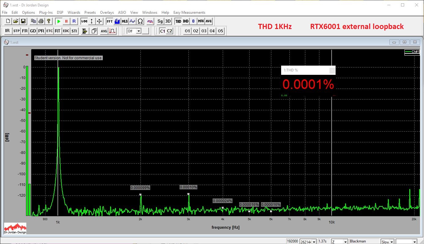

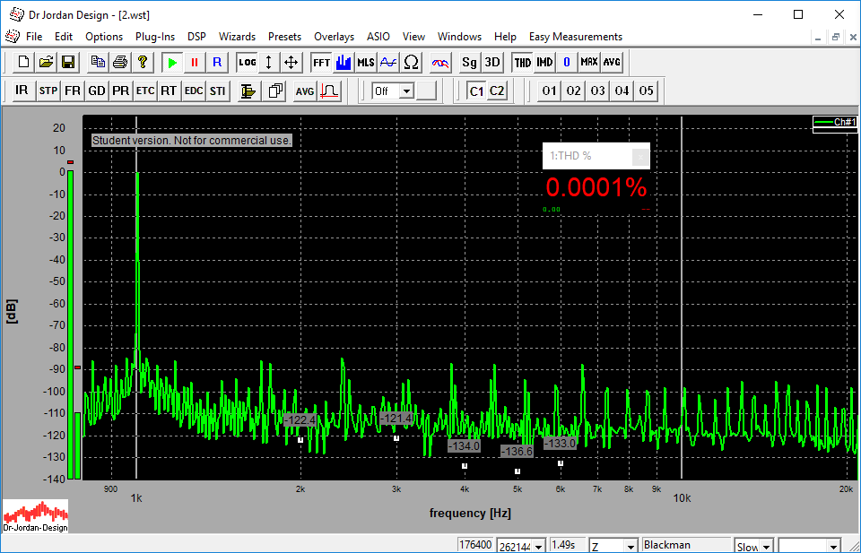

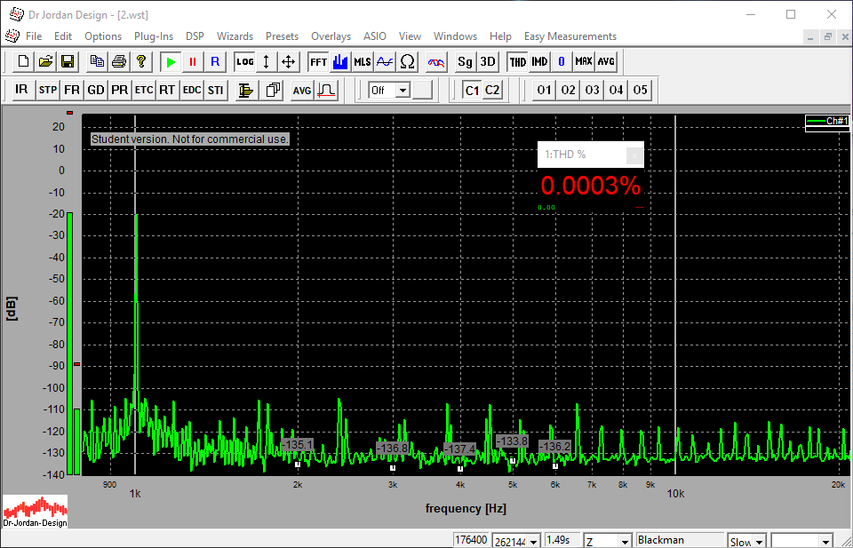

Again, here is what I mean:
1) Attenuators'settings at the analyzer;
2) 1KHz spectrum that I see on my desktop workstation (0dbV level, roughly 250mV RMS);
3) SAME 1KHz spectrum on the notebook;
4) same 1KHz at -20dbV level.
This is what actually puzzles me. Same setup, same cables, same settings, same software, same win10, etc.
I was going to use the notebook in the lab, but I at the moment it works perfectly only on the desktop (that I brought to the lab to check if the system works well with it - it works well with it.

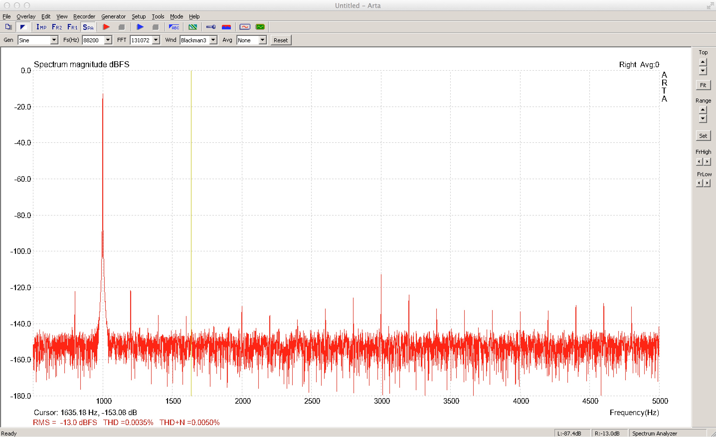

On your laptop the Sample rate is 176,4kHz, on your desktop 192kHz.
Are you sure, with your laptop, that the actual sample rate of the RTX is not 192kHz?
I am here on a Mac, I can/must set the software and hardware sample rate and bit depth independently.
I can produce "similar" pictures if I set the software to 88kHz 24 bit (Arta does not support 176,4kHz) and the RTX to 96kHz 16 bit. The 16 bit is not necessary but produces more distortions and higher noise floor.
That's right - I have adjusted the sample rate to 176.4 KHz deliberately, because if I set it to 192 KHz (or any other multipied by 0.5, like 96 and 48), measured harmonics get aligned with the "garbage" components, so THD measurement will show much higher value.
With 176.4, 88.2, 44.1 KHz the "good" and "bad" components are not aligned, so the measurement is good enough, even though those harmonics are surraunded by the "garbage".
WinAudioMLS sets paramerets for the ASIO driver - whatever I set in the software, is visible in the ASIO driver's status screen after I press the "Run" button.

Success
OK, I made it working properly.
There's still some "magic" involved 😛 I have simply copied the configuration file from the desktop (working well) to the notebook (showing garbage). After some tricks (WinAudioMLS crashed a few times when I tried to load that saved configuration - there is some issue in WinAudioMLS when the sample rates do not match), I've got it running exactly the same way, as it runs on the desktop - no "garbage", even at 192KHz sample rate.
Trying to understand what configuration parameter makes the trick - no luck so far. Anyway, I can use the notebook in the lab - that's the point 🙂
BTW, the situation with Lynx L22 card is exactly the same - with default settings it shows the same garbage, my "magic" config file makes the trick (on the desktop it's loaded at startup). Looks like I did something clever with the configuration in 2014 - can't remember what it was now. Am I getting old 😀

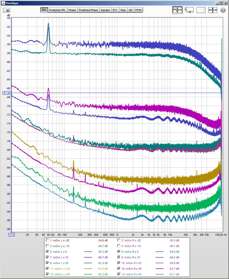

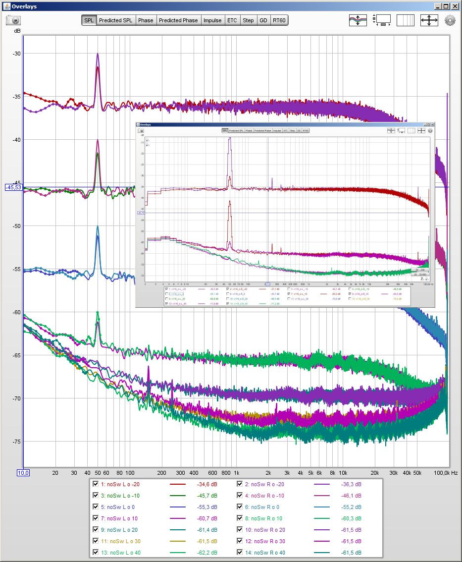

Is the mains power now running through the whole case to the switch in front?
In case the cable to the front switch is not used, the picture changes (cf. first attached thumbnail)Yes it is. So far I haven't noticed any drawbacks from this.
- inserted diagram shows what I got with power switch cable in use
- 50 Hz peak is much higher at the left channel
- without that cable both channels are almost identical - great 🙂
If I remember correctly, there is an amplifier involved below 20 dB - looks like this amp reacts on mains.
- would like to learn how to cue that, too
The second attached thumbnail gives strange noise curves at the rigth channel with higher averaging - would be great to have the right channel as smooth as the left one - any ideas?
