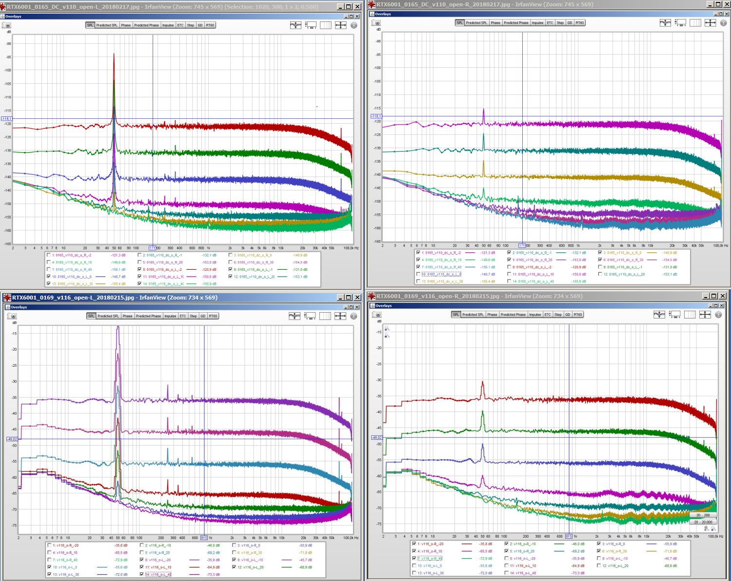

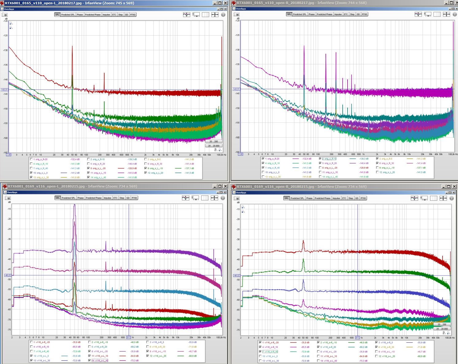

I've two RTX6001 at hand:
See image attached (RTX6001 where located at different places; quite likely not all settings where the same)
TIA
Ulli
- snr 0165 v1.10
- snr 0169 v1.16
0165 left ... 0165 right
0169 left ... 0169 right
- 0169 left channel shows much more mains hum compared to 0169 right channel
- 0169 noise floor varies much more than it does on 0165 (except for -20dB setting)
- at both devices, right channel has much more curly noise above 1 kHz than left channel
- 0169 noise floor does show low pass behaviour which is not seen at 0165
that was also the case with v1.10
TIA
Ulli

now with both devices having open input (pls ignore #923):
Ulli
- snr 0165 v1.10
- snr 0169 v1.16
- left channel shows much more mains hum compared to right channel
- right channel has much more curly noise above 1 kHz than left channel
- 0169 left channel does show additional mains spurs
Ulli

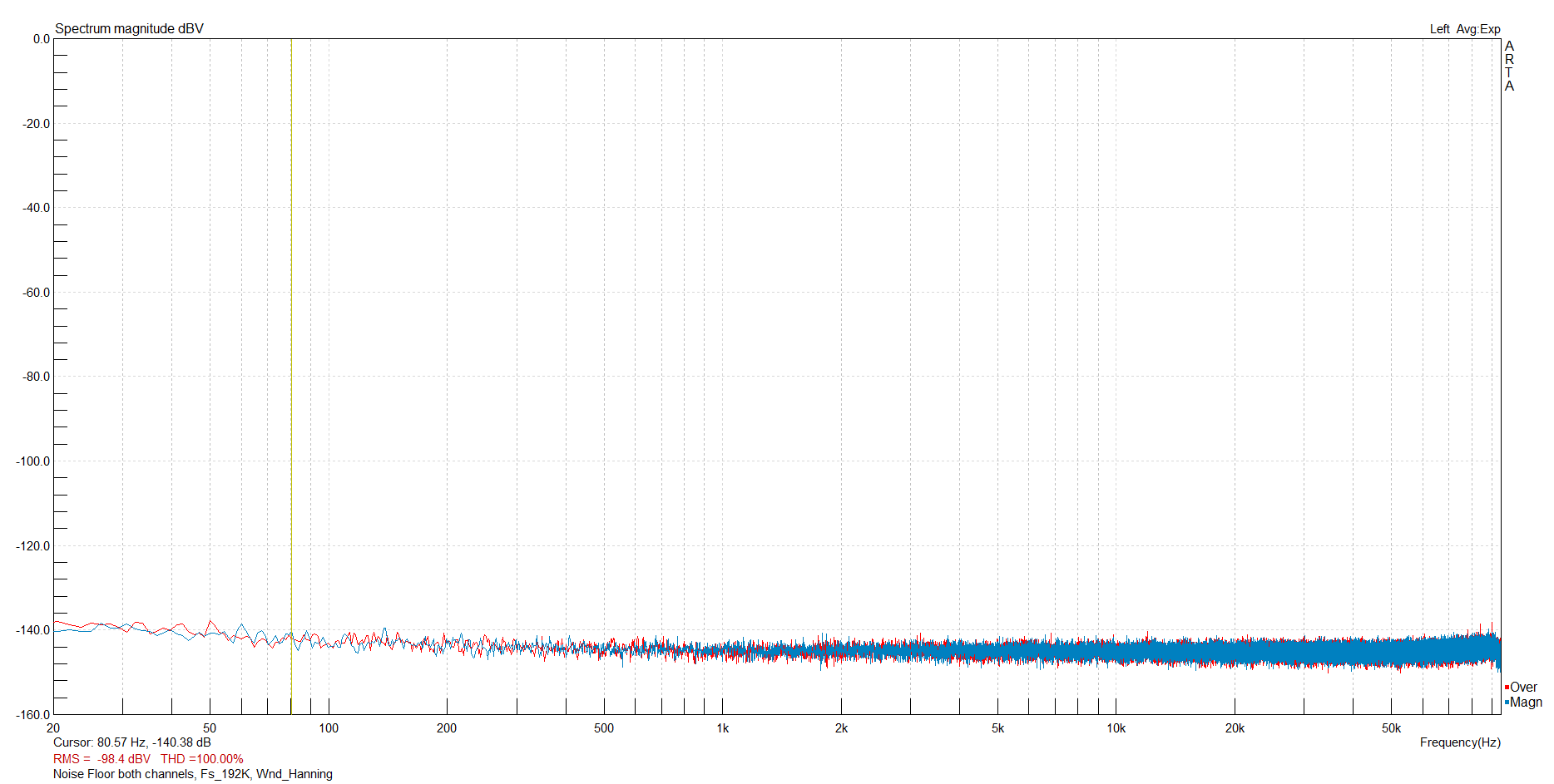

@modmix - Are these captures with no any cables at inputs-outputs?
1) I see a lot of hum at the left channels, both units
2) the noise floor has strange response at the range.
The attachment is capture of noise floor both of channel, without any cable on these. The knobs set 20dBV/20dBV for inputs-outputs, the Fs is 192K, the FFT is 131K and the Wnd is Hanning.
Everything is straight and clean, the hum from right channel has disappeard due vertical shields.

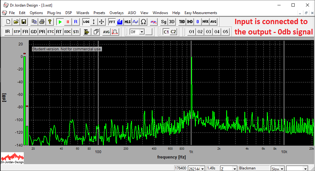

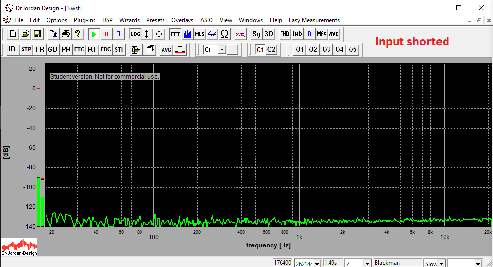

I did some more test runs. Pictures below (unbalanced input):
1) input is shorted;
2) input is connected to the output (short shielded cable) - no output signal;
3) same as above, but having 1KHz @ 0db at the output.
I tried different setups with regards to grounding - no change.
Still working perfectly (no artifacts at all) as soon as I connect the analyzer to the big desktop workstation...
The first (1) is OK.
The second (2) has an impact of a little 50Hz hum, that generates a multiple spikes until 600Hz. I don't know if you have more hum sensitive unit or it is something from the measurement. The vertical axis is to dBV, if I see well.
The third (3) is not good and I don't know why, if your measurement setup was at the 0dBV for the output-input.
What is the dB of your gen? Probably, you tried with 0dB at the gen, else make a measurement with the same setup but with -3dB gen signal.
