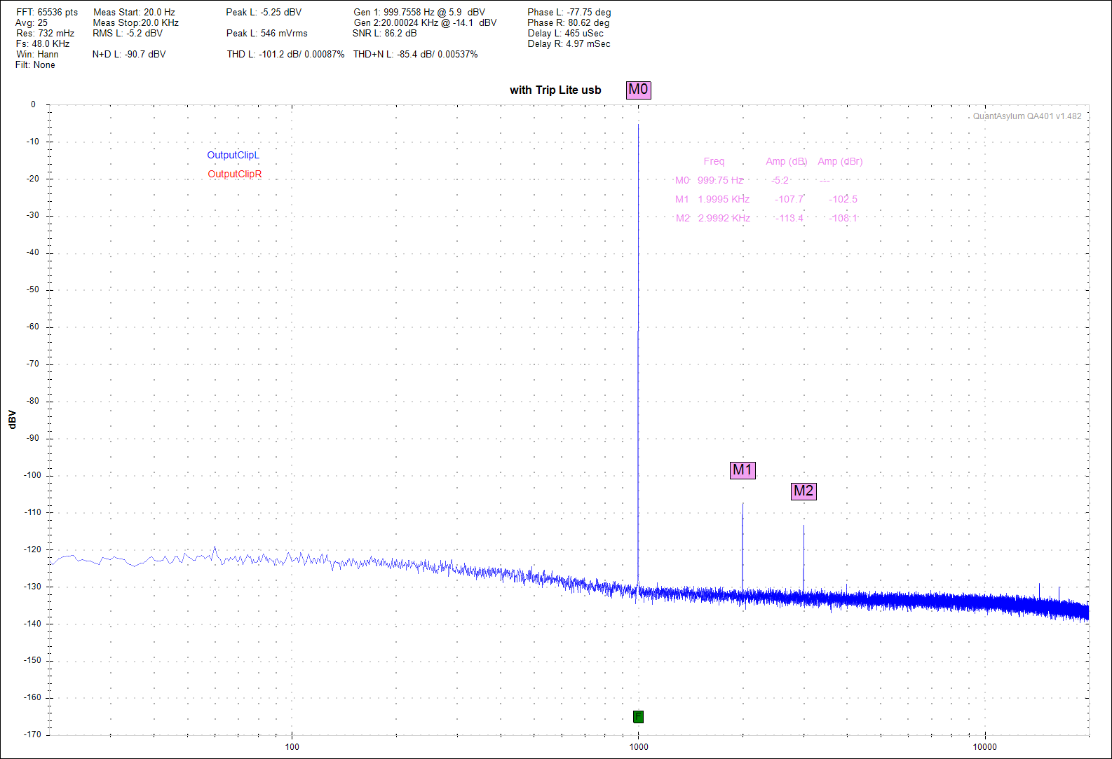

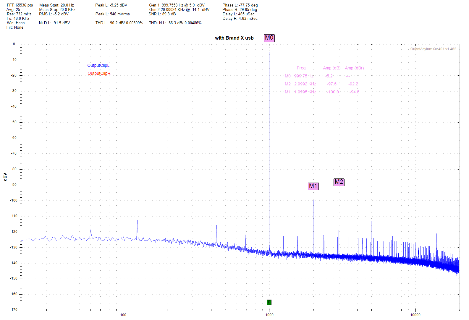

Tripp Lite USB cable
Amazon.com: Tripp Lite USB 2.0 Hi-Speed A/B Cable with Ferrite Chokes (M/M) 6-ft. (U023-006): Electronics
The other USB was a random, Brand X, cable from the surplus store.
The Brand X USB is the door to what looks like computer power supply noise.
The Tripp Lite USB cable does not allow any of this interference.
See the attached QA401 FFT plots. (GE 0.68 uf PP cap)
DT
Yes the Tripp Lite USB made a world of difference. The usb came in a box from Audio Precision. The Tripp Lite USB cable looks like this one.I believe the manual states that the only thing in the box is the analyzer, USB and power cables are needed. Also you will probably need to reset the mains voltage if you are in North America.
I am fairly cable agnostic particularly when it comes to things like USB cables as long as they comply with the standard. So if as you say "there was a world of difference" you need to provide us with either anecdotal evidence like: "the device actually worked reliably" or a more qualitative assessment like: "the SFDR improved by 12dB at 15kHz" or "the noise floor dropped 3dB or more over a 20kHz bandwidth"
Some details about the cable that proved superior would be helpful too so that if this is real the rest of us can cause a run on that particular cable.. 😀 As written I would assume the Tripp Lite product was inferior which would surprise me given my experience with their products and the engineering rigor which AP is noted for.
DT
the user manual indicated that the RTX USB input is galvanically isolated unlike the quantasylum. So I guess results may vary. Thanks for the measurements tho - very useful nontheless!

Yes the Tripp Lite USB made a world of difference. The usb came in a box from Audio Precision. The Tripp Lite USB cable looks like this one. <snip>
Wow! What a difference!
Should give it a try~
The USB cable is maleA to maleBYes the Tripp Lite USB made a world of difference. The usb came in a box from Audio Precision. The Tripp Lite USB cable looks like this one.
What do we need for the RTX6001?
You need a B-connector for the RTX6001, so the A/B cable from the link above should be OK.
The type of cable is described in the Quick Start Guide and in the User Manual. In these documents it is stated that a cable is supplied with the unit. This is not correct though for the GB units.
Since the USB interface on the RTX6001 is isolated from the rest of the unit, I don't think that the ferrites on the cable will make much difference, if any at all. But of course, it never hurts to have ferrites on the cable.
Thanks for confirming that.
I have three spare maleA to maleB USB cables.
The shortest has dual ferrites. The medium and long are without ferrites.
Looks like I will need to copy the DualTriode cable test method, to see if the RTX is tolerant of cable type/quality.
