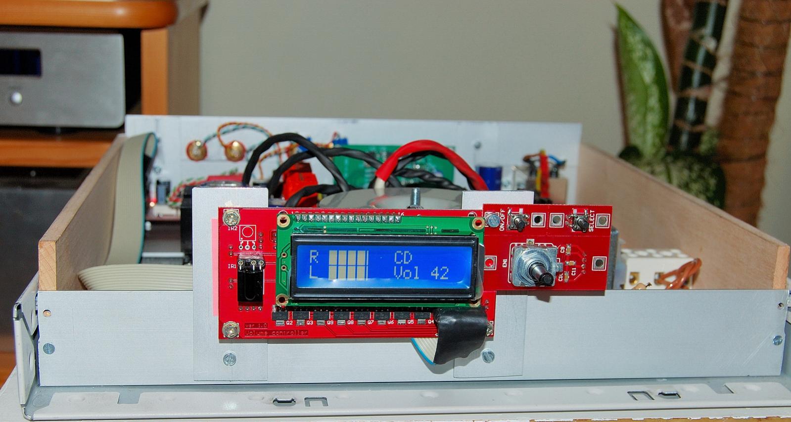

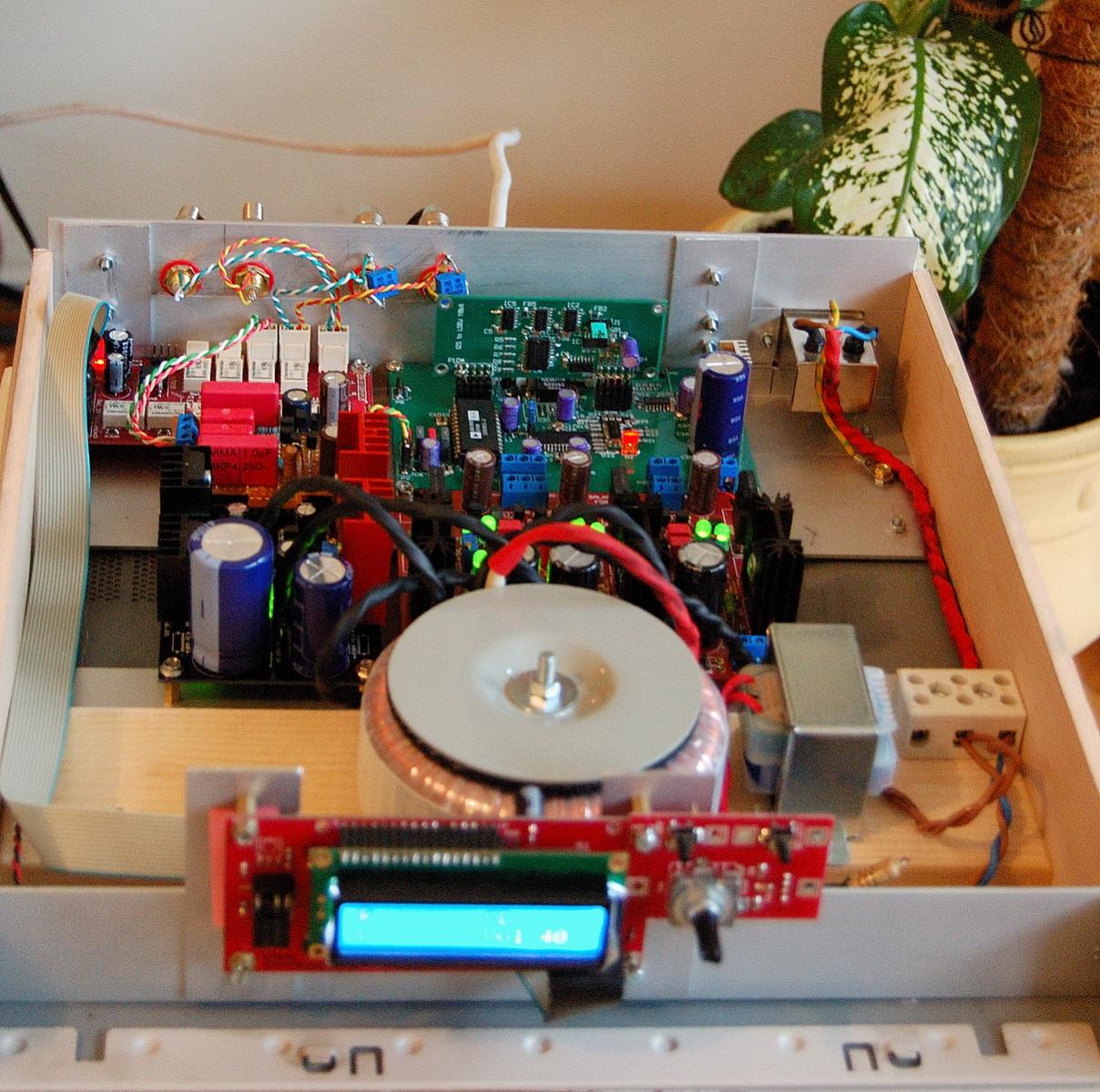

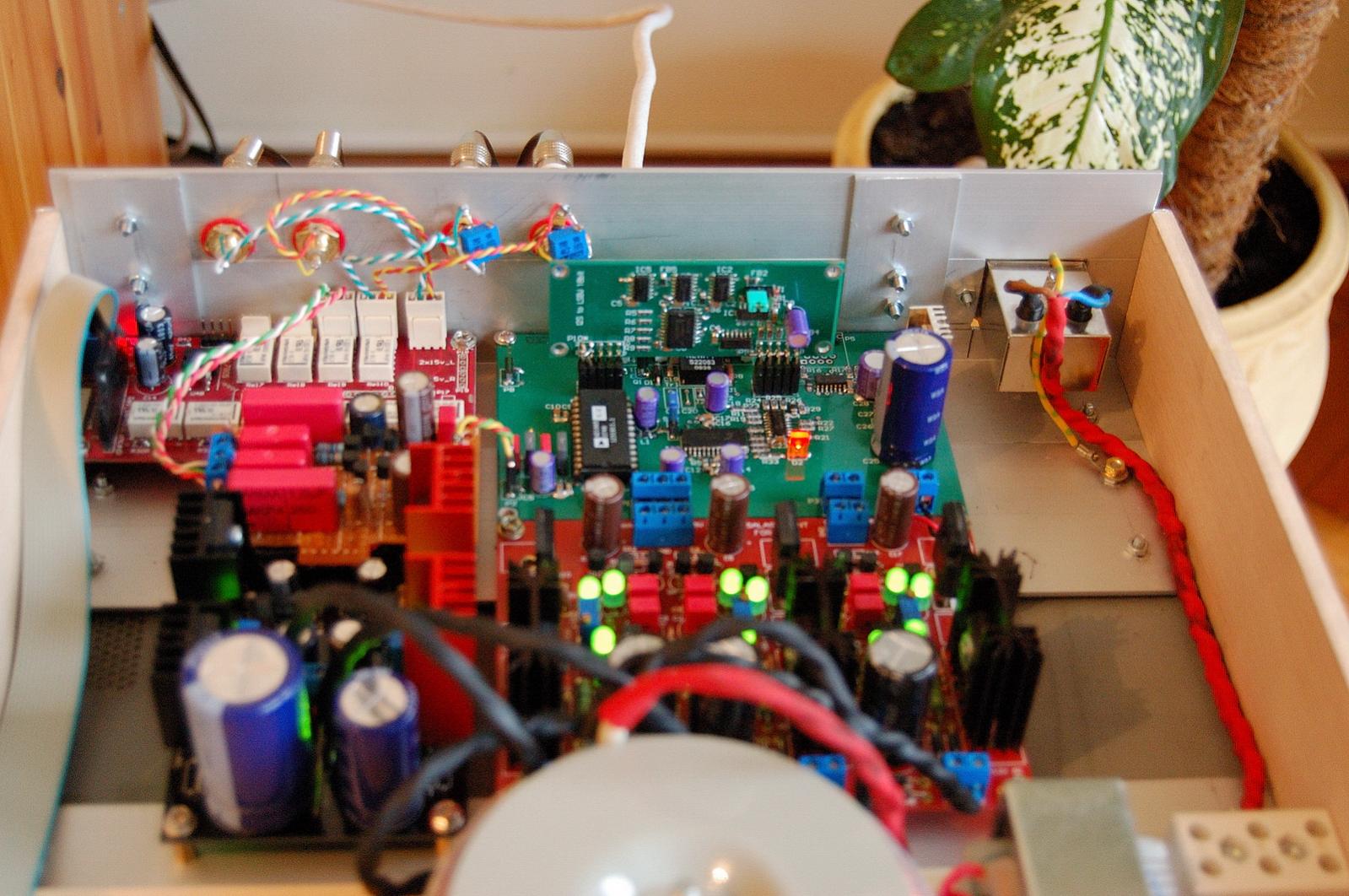

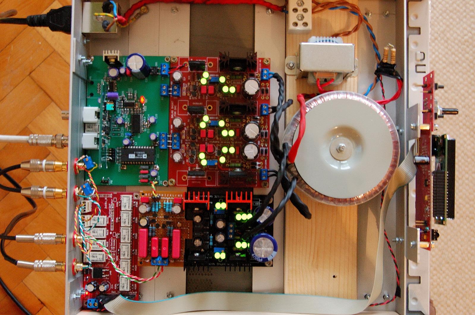

My controller
My version of this volume controller with FarmTech's firmware, connected after a NOS DAC and JBoz like preamp.
The controller worked smoothly from first, just follow the instructions.
...the case is yet to be finished 🙂
